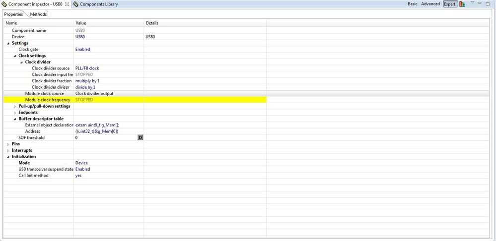

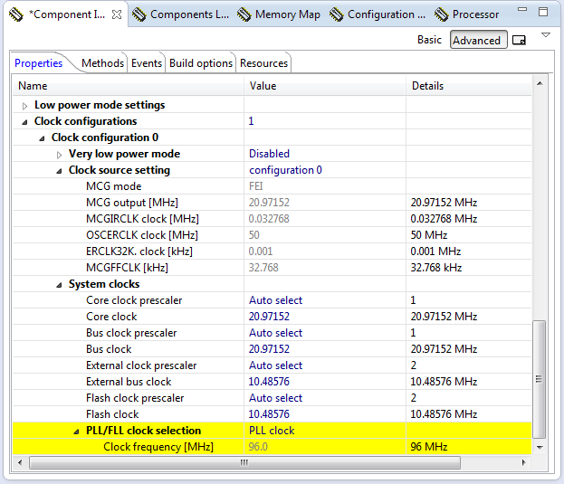

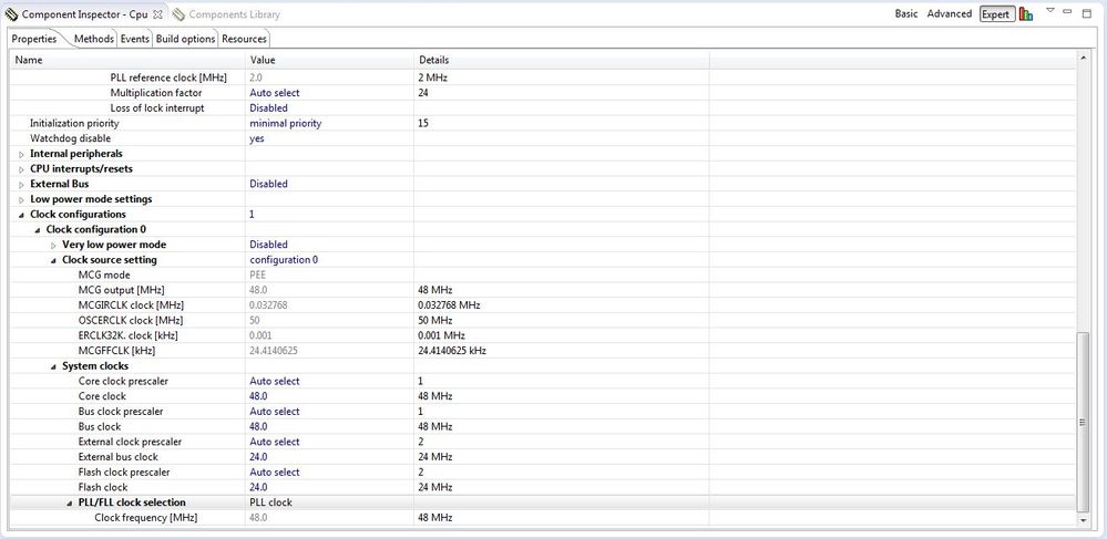

I want to add USB CDC to my custom board with MK60DX256.
I follow this guide http://mcuoneclipse.com/2013/04/27/usb-cdc-with-the-frdm-k20d50m/ but I have a trouble in USB0:Init_USB_OTG.
The problem is into USB_Init in the Module Clock Frequency that remains STOPPED (not 48 MHz).
I attached three pictures that show the clocks configuration.
Could anyone help me?

I had no problems to set it up using CW 10.6 (with update 4). Attached is a test project (I have not run it on hardware!), and the settings work for me.

From your screenshot, you are in basic, not in Advanced/Expert mode (upper right corner): then the setting shows up:

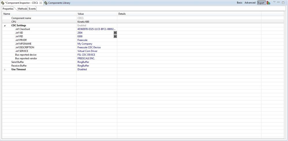

I think USB_CDC add Virtual COM support but now I realize that isn't true. Isn't it?
Which PEx component I need to add to get Virtual COM functionality?
Thanks for your help!

BlackNight
Hi Frederico,
this one is for K64F, but should pretty much apply for K60 too:
http://mcuoneclipse.com/2014/10/25/usb-cdc-with-the-frdm-k64f-finally/

I switched to Expert Mode and the PLL/FLL Clock Section appears, but I can see USB Clock Settings.
Can I upgrade my CW to 10.6?
Thanks for your time!
Federico
7,565 Views
BlackNight
what version are you currently using?
You can download 10.6 and install it side-by-side, so you still have your current version available, just in case.
That^'s actually the way I recommend to switch to a newer version anyway: keep the existing one installed, until your projects are migrated (or you might keep using the older version for your older projects).

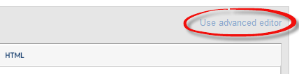

Jorge_Gonzalez
Hello Federico_R:
If possible please share your project. That way we can give it a check.
To attach files you have to click "Reply" then "Use advanced editor":
Regards!
Jorge Gonzalez

I switched to Expert mode in ProcessorExpert and I can set PLL Clock under (PLL/FLL Clock Section), but the USB clock setting doesn't appear under this section.
In fact, when I debug the project, the CDC_Task return: ERR_BUSOFF; /* USB bus not available yet */
Which is the problem?
I attached my project, create with CodeWarrior 10.5 and the ProcessorExpert developed by Erick Styger.
