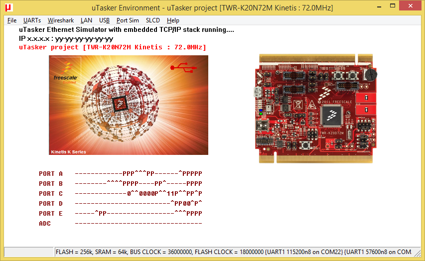

If you use the uTasker project with the K20 it will allow you to define settings and will also warn you if anything is out or range:
KINETIS Project Code
I have posted a screen shot of a 72MHz K20 in operation in its Kinetis simulator where you can see the clock information being shown. The clocks are simulated and it is easy to step through the code to to see what is happening and experiment.
