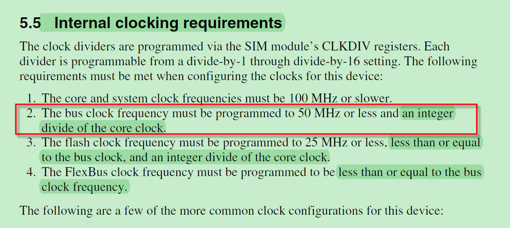

kerryzhou
Hi Alessio Paolucci,
    Actually, the K60 reference manual already describ the relationship between  bus clock frequence and the core clock frequnce.
Just like the following:
Wish it helps you!
If you still have question, please contact me!
Jingjing
