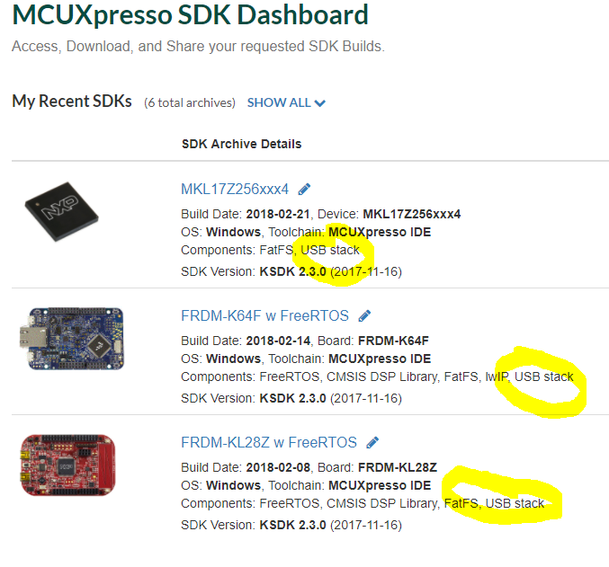

geoffsokoll
Where can one find this USB Device Reference Manual ?  I've searched through all of the SDK directories I have for various FRDM boards, and it isn't anywhere to be found...

geoffsokoll
I've installed the SDK's by drag and dropping into the "Installed SDKs" window within MCUXpresso.
The docs directory only has two pdf's, and neither relate to USB.  See below example for FRDM-K64F.  Similar results for other boards I have (eg K22F, KL27Z, KL28Z etc).

Hi Geoff
It may be that you need to specify that you want the USB library when generating the package. If you don't do this the documents may be missing.
I have attached a copy that I have.

geoffsokoll
Thanks Mark.  I did specify the USB stack for all of my recent SDK builds - see below
