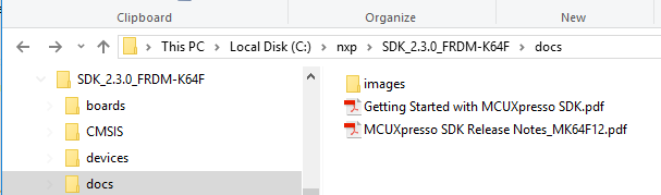

geoffsokoll
I've installed the SDK's by drag and dropping into the "Installed SDKs" window within MCUXpresso.
The docs directory only has two pdf's, and neither relate to USB.  See below example for FRDM-K64F.  Similar results for other boards I have (eg K22F, KL27Z, KL28Z etc).

geoffsokoll
Thanks Mark.  I did specify the USB stack for all of my recent SDK builds - see below
