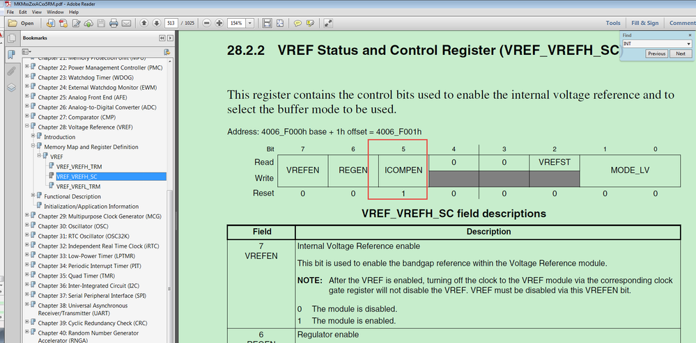

Hi Charles,
    I didn't find any document describe the difference between MKM14Z128CHH5 and MKM14Z128ACHH5 directly, MKM14Z128ACHH5 is the new silicon version.
  But I do the comparison between the header files and the reference manual for MKM14Z128CHH5 and MKM14Z128ACHH5.
  I just find one different point: VREF_VREFH_SC
1. MKM14Z128CHH5
2. MKM14Z128ACHH5
After the comparison , the MKM14Z128ACHH5 add the VREF Second order curvature compensation function, except this, all the other modules are the same.
So, you can use MKM14Z128CHH5, just take care the Second order curvature compensation function in VREF, this chip don't have it.
Wish it helps you!
If yous still have question, please let me know!
