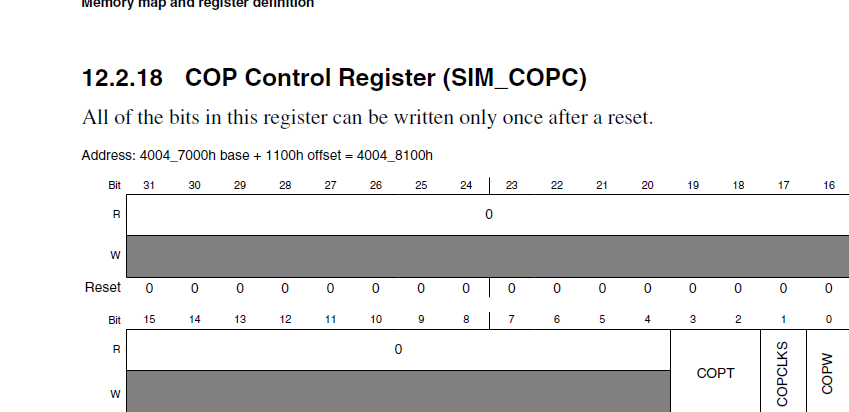

Hi, I tried to follow the cop example project to use the watchdog, but I noticed the COP_Disable(SIM); works fine in the example project. So now, I would like to flash my LED after watchdog timeout reset, then clear the watchdog timeout flag, then restart the watchdog, it didn't work on my project unfortunately. I found that the COP_Disable(SIM); won't disable the COP, plus the SIM_COPC_COPT did not change, this bit won't change even i write into the register directly.

Do you pay attention to the fact that the SIM_COPC register can be written only once after Reset?
Hope it can help you
XiangJun Rong

Yes, i found that after i sent this question.
if this is the case, then how could I clear the WDOG flag on both RCM_SRS0 and RCM_SSRS0 registers?
As you may see my code, I use the RCM_ClearStickyResetSources(RCM, kRCM_SourceWdog); to clear the flags, but the WDOG show up the next loop. Plus the RCM_SRS0 is read only, is it clear only at POR?
