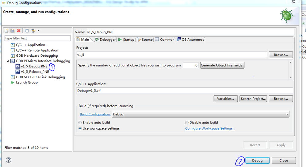

Last is how i load the code into the actrual mcu: I don't configurate anything ,choose 1 and press 2.
Is there any problem?

There is still a problem confused me that what is the difference between  "v1_5_Debug_PNE"and "v1_5_Release_PNE" and which one should be used to load into the mcu.
In Build Configuration:Debug ; Use Active;Select AutoMatically;Release .Which one should I choose?
3,097 次查看
FelipeGarcia
I recommend you to check the post below from a colleague:
https://mcuoneclipse.com/2012/06/01/debug-vs-release/
Hope it helps!
Felipe
