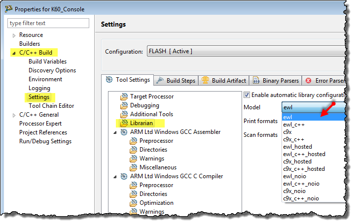

Jorge_Gonzalez
Hello Sam:
Seems you have conflict with low level IO support.
I assume you want to direct your console functions (printf, ...) to a UART channel, is that correct?
In that case, from the New Project wizard , you should have selected UART, not Debugger Console.
To correct this, go to Project -> Properties -> C/C++ Build -> Settings -> Librarian, and make sure you have the "ewl" library selected, instead of "ewl_hosted".
Let us know if this helps to correct your issue.
Regards!
Jorge Gonzalez

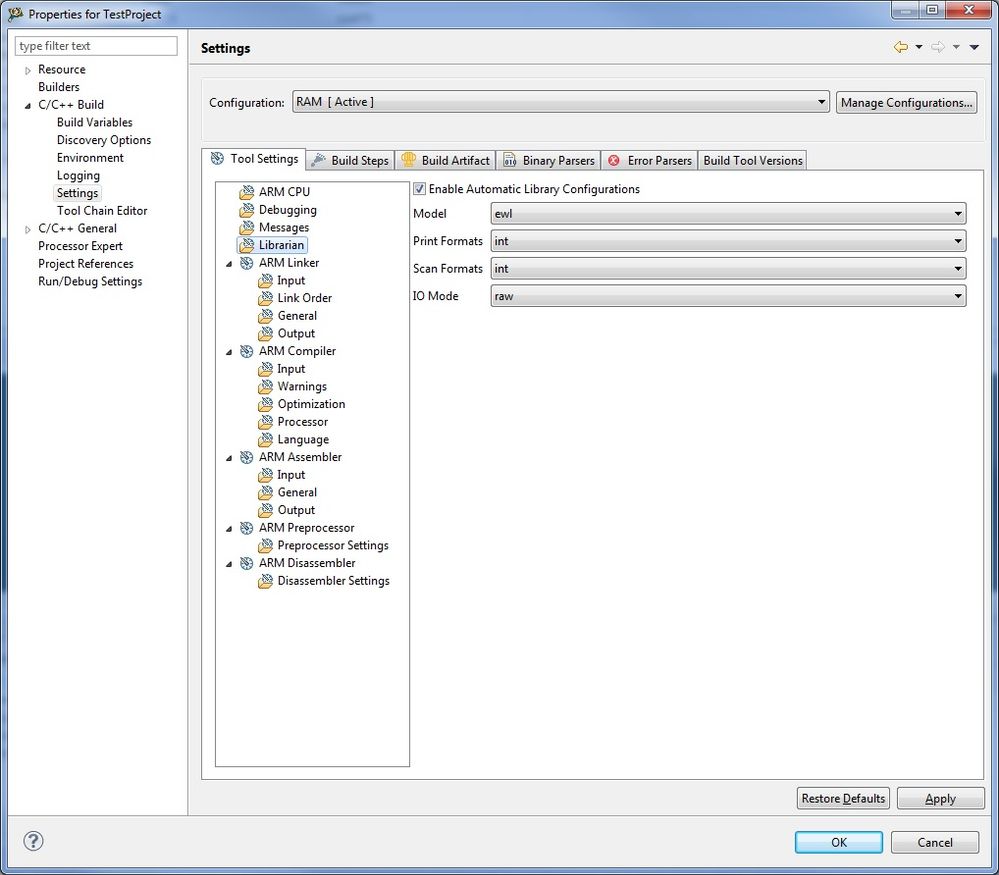

sryan
Hi Jorge, thanks for the answer!
You are correct that I am trying to redirect the console output to the UART.
When I started the project I chose "Freescale" under Arm Build Tools, so it looked like this:
If I select GCC instead of Freescale at that screen I do see the UART radio button, but with Freescale selected I don't see it. Should I use GCC instead of Freescale? I'm not really clear on the differences to be honest.
I checked under Project -> Properties -> C/C++ Build -> Settings -> Librarian and it looks like I do have ewl selected, I included a screenshot.

Jorge_Gonzalez
Hello Sam:
Sorry, I jumped the gun and thought you were using GCC. In that case the warnings are due to multiple definitions, but according to these warnings the functions ignored are those of the libraries, and your functions included with the ConsoleIO component are the valid ones, then you should have no problem. Have you tried to use prints? They should be directed to your selected UART channel.
As for your other question, it is recommended to use GCC build tools instead of Freescale tools. GCC produces smaller and more efficient code. Besides Freescale tools are no longer developed and the default option is to use GCC.
Hope my reply is useful!
Jorge Gonzalez

jonathanscott
Jorge,
Thanks for your reply. I did figure it out, and it did indeed have to do with the librarian model setting. It was incorrectly set to EWL instead of EWL hosted.
Jonathan
