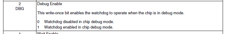

Thank you for the responses.  As for WDOG in debug, I am setting the DBG bit within the WDOG_CS1 register.  My understanding is that this will enable the WDOG during debug.

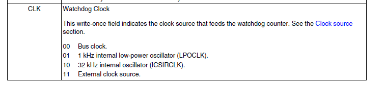

Once this routine is complete the TOVAL (BIG Endianess) is set @ 1000 for a 1 second (Supposedly, The value of CLKS is 0x03 (WDOG_CS2_CLK_MASK = 0x3u) so it is clocked by external NOT the 1 kHz internal LPOSC as described in comments by FS).  WDOG_CS2 - 0x03 setting the CLK source to the External Clock Source
WDOG_CS1 disables the WDOG, Allows updates at a future time, Enables WDOG in chip wait mode, and Enables WDOG in chip stop mode

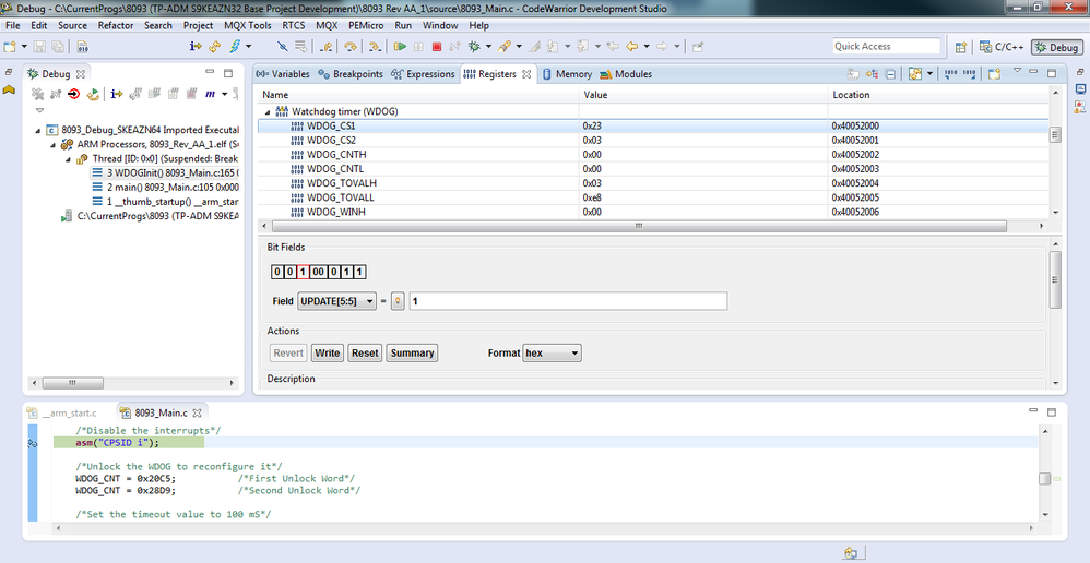

I launch CodeWarrior, and import my elf file that is generated.  I set a break point within my WDOGInit routine where I turn off the interrupts. And I run.
The WDOG registers are set as expected CS1 = 0x23, CS2 = 0x03, TOVAL = 0x03e8.

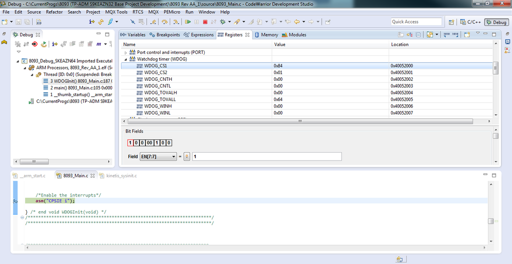

I try stepping into the next instruction but using the debugger I get a reset, so I place a breakpoint at the spot I re-enable the interrupts and allow the code to run.
Again the registers are setup as expected.  CSS1 = 0x84 (WDOG enabled, and WDOG enabled during debug),  CS2 has the CLK set to the 1KHz LPOSC, TOVAL is set at 100 for a reset @ 100 mS.  I then allow the code to run,  It then enteres the infinite loop and begins to toggle the LED connected to PTC0 and never show any sign of resetting, ("Wiggle" LED Signals).

Hi Patrick, glad to hear you got through the endianness issue with the WDOG_TOVAL register, I just went through that exercise myself.  One thing I discovered which I think is slightly misleading is the enable bit for debug.  I found that you may not want to enable it in debug, because the watchdog will actually do what it's supposed to do if disabled while debugging, despite what Jorge says.  I found that if that bit is enabled, the counter will continue running if you pause execution, so if you set a breakpoint or try stepping through code, the watchdog will reset it.  If you leave it disabled, the watchdog will still do what its supposed to do, but the counter is suspended if you stop execution so you can still debug.  At least on a KE06 that's what it does.
Since I made this mistake, are you single stepping through the lines where it's initialized?  It won't work because the bus clock still runs and the window to configure it will expire as soon as you pause execution.

According to the reference manual, the watchdog is disabled by default in Debug mode. So if you are trying to get a watchdog reset while debugging, this will not happen.
