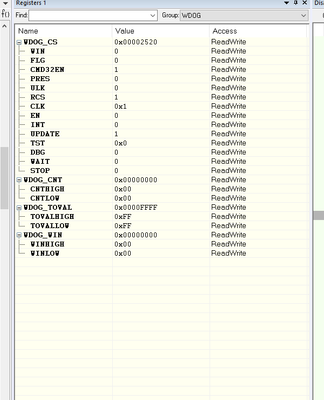

I am not sure what is going on with IAR.  When I set the debugger up to not run to main, and step through the system_MKE18F16.c code, the values in the register file are not correct according to the reference manual.

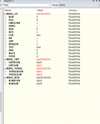

These are the values I see before running any code in the system_MKE18F16.c file.  It seems as if the values that are inside the #if (DISABLE_WDOG) are somehow showing up in the register fields.
In the code that I am executing, I set the DISABLE_WDOG to 0, and give it my own configuration of this:
Not sure why I can't see the startup values that in the reference manual.
