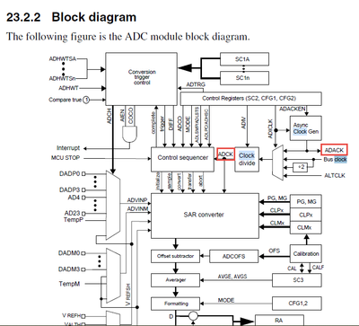

I suppose that you use K32L2 family, this is the ADC block diagram, from the diagram, you can see that the ADC clock ADCK can be from 4 sources:ADCACK(fADCACK ADC asynchronous clock source), Bus clock, divided2 bus clock, ALTCLK.

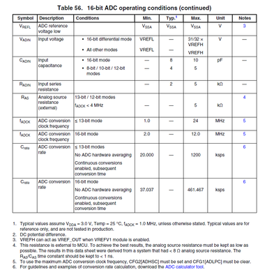

If you want to get the highest conversion rate, you have to select Bus clock, which can reach up to 24mhz, the ADC conversion rate can reach up to 1.2MBPS.
This is the table using bus clock:

This is ADC block diagram.
For the detailed conversion rate computation, pls refer to 23.5.4.5 Sample time and total conversion time in K32L2B3xRM.pdf

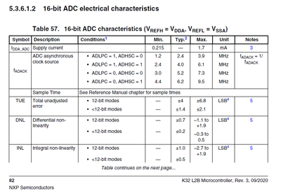

Judging by table 57 from the datasheet, it appears that ADHSC only affects the achievable clock frequencies when using the Async Clock. Is that correct? (Though it always adds 2 cycles if enabled, regardless of clock source?)
4,005件の閲覧回数
xiangjun_rong
Yes, when you set the ADHSC bit,two more ADCK cycles are required to convert one analog channel.

Now I see in footnote (5) of Table 56 that ADHSC maybe does apply even when using a clock source other than the Asynchronous Clock ADACK.
I also see in the reference manual:
CFG2[ADHSC] must be used when the ADCLK exceeds the limit for CFG2[ADHSC]=0.
Are these limits published anywhere? In Table 56, it lists the minimum and maximum f_ADCK, but it doesn't describe what the limiting case for ADHSC = 0 is.
For example, with ADICLK = BUS Clock (24 MHz), and divisor = 2, the ADCK is 12 MHz. This is at the maximum for 16-bit conversions, so I assume this requires ADHSC = 1 . Is that correct?
With divisor = 4, the ADCK = 6 MHz, which is in between the minimum and maximum f_ADCK for 16-bit conversions. Is this achievable with ADHSC = 0?
