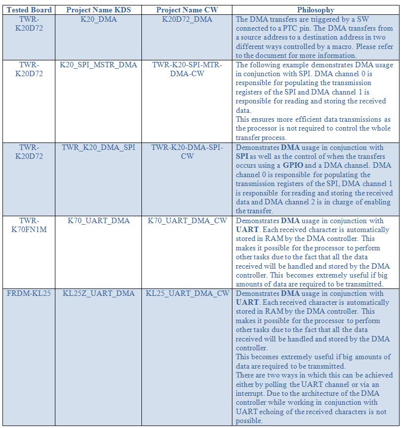

Each folder includes 5 examples that are:
Please feel free to modify the examples; I hope this will be useful for you.
Many thanks and credits to manuelrodriguez for his valuable help developing and editing this project.
:smileyinfo:For the SPI examples it is necessary to make a bridge between MOSI and MISO pins (master loop mode is used for the example). For this the TWR Elevators were used.
    In the attachments you can find some extra information when using SPI and DMA.
