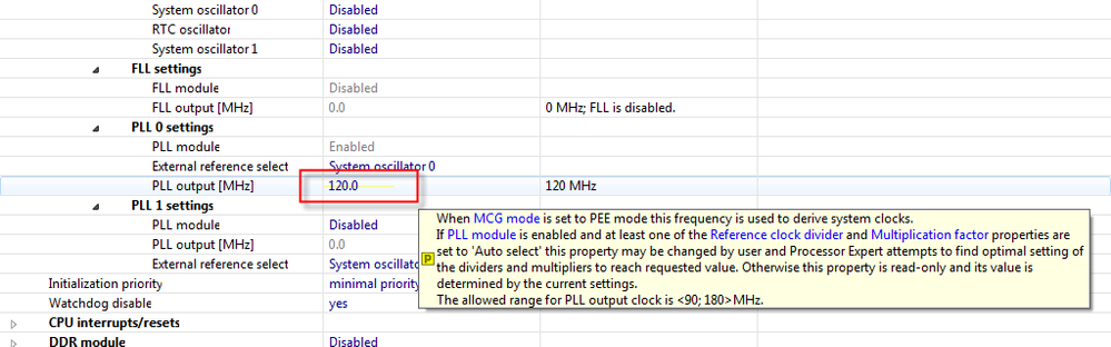

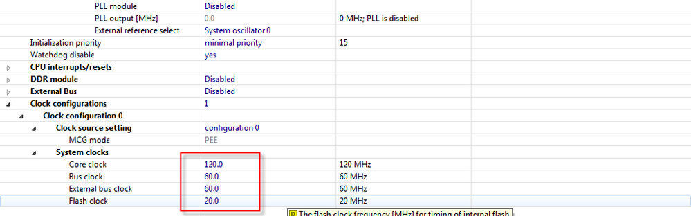

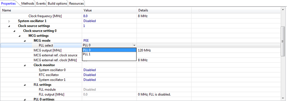

According to my experience on PE, I think you may configure the clock source from ref clock to crystal by the following steps:
1. change system oscillator:
2.change MCG mode and PLLx
3.Set PLL output freq:
4.Set system clocks:
Hope that helps,
Kan

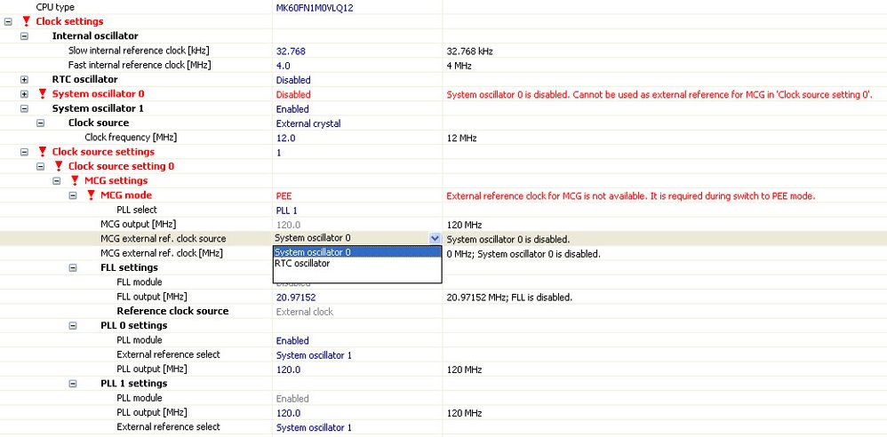

ARQuattr
Thank you Kan,
     It looks like you have it set to use XTAL0.  If I try to set it up using XTAL1, I'm not able to select oscillator 1 for the MCG reference clock.  Please see the attached image.
     Using the demo project for the K60 tower board, on my custom board that has a 12MHz crystal on XTAL1, and nothing on XTAL0, the crystal oscillates but the device doesn't run.  I tried to redirect the clock to MCG (as shown in the image, and also changing MCG control registers directly), but I can't get it to run.
     If I rewire the crystal to XTAL0, it doesn't oscillate.  I enabled the PORTA_PCR19 MUX (since it was getting a reference clock on one pin only and not a crystal connection on the tower), and I enabled the oscillator (EREFS0=1 in MCG_C2), but I still don't get the crystal oscillating.
     I'm not sure what to try next.
Angelo

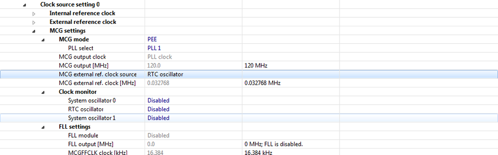

Kan_Li
Hi Angelo,
The RTC oscillator is needed for such case, that might add a little bit cost for a 32.768KHz crystal, but you may configure the clock as below:
I have also successfully implemented it based on TWR-K70, you may try it as well on TWR-K60F120M.
