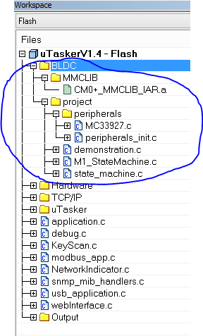

- By adding the header files and a handful of C files from the original project, plus the CM0+_MMCLIB_IAR.a I could build the BLDC_Sensorless project (with IAR)
- It has the uTasker OS with DMA based UART drivers for UART0 at 115'200 Baud (command line shell interface with quite a lot of functionality; RTC, accelerometer, lower power support, etc.) and UART1 (FreeMaster at 9'600 Baud)
Apart from connecting wiith FreeMaster and viewing variables (and seeing soem output pulses) I can't test the BLCD_Sensorless operation (also no motor/extension board available) but I could verify that the ACD0, FTM1 and FTM2 interrups are operating.
The only changes to the driver code used by the motor control part was to configure the interrupt to match the framework style (and operate in RAM), which looks like (eg.)

Below is a screen shot of the IAR workspace showing the BLCD part inserted into the uTasker application framework:

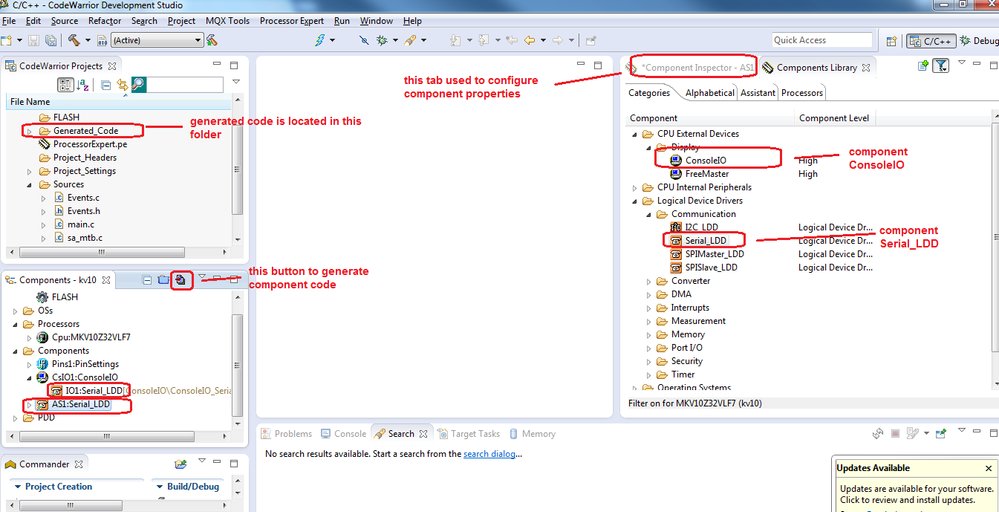

Rick_Li
Hi Flack,
I would recommend using CodeWarrior v10.6 (download it directly from Freescale website) and creating a project by yourself.
it is easy to do it by using Processor Expert (a software tool that integrated in CW).
the step is as below:
1. launch CW v10.6 and click "File"->"New"->"bareboard project"
2. give a name to the project and select "mkv10z32" as the device.
3. "CHECK" "OpenSDA" in step "connections"
4. choose "Processor Expert" in step "Rapid Application Development" and then click "Finish", you will created a new project
5. in the new created project, from "Component" tab, double "ConsoleIO" to add this component to this project. then confige this component IO1 to UART0.
6. add another component "Serial_ldd" to project and confige to UART1.
After configuration, generate code.
Add your code in main.c.
printf() will output string to UART1 from USB port when debugging by using OpenSDA. data put from UART1 will output to UART1.
the UART communication methods are in the generated PE files.
Hope it helps!

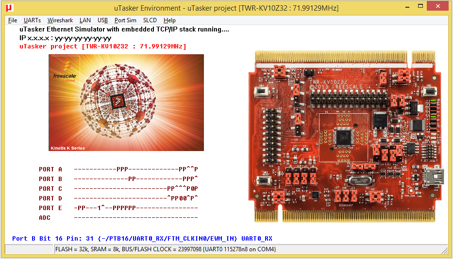

mjbcswitzerland
Specialist V
Hi John
I don't know which SW you are referencing to or what is presently available for this device but if you are feeling brave you are welcome to try with the (extremely) new TWR-KV10Z32 framework in the uTasker project.
I have attached a binary for the TWR-KV10Z32 which has a UART menu (shell) on the OpenSDA UART0 connection (115'200 Baud). The accelerometer is being read and output values are written to UART1 (by moving the jumper on J22 from the default setting 2-3 to 3-4 this (also 115'200 baud) this will be sent over the OpenSDA virtual COM port - but is of course available as UART signals in parallel).
Both UARTs are operating in DMA mode and there are various other things that it does - mostly controlled in menus on the UART0 connection.
Truth is I started the port only a few hours ago but since the KV is very close to a standard K device almost all standard driver code works on it (with a few adjustements here and there). I only checked a few things like UARTs and I2C so there will probably be a few more adjustments needed before it can be called complete. However the uTasker simulator has been adapted to the board so that it accurately shows pin usage etc. Screen shot below.
A couple of things that I haven't understood just yet:
- the FLL is operating at 50MHz; when trying 75MHz it runs but looks to not manage to lock correctly and there may be something needed to get the high-speed mode going correctly.
- I am having a hard time with the debugger - if I run the FLL derived from the fast internal clock it behaves well but running with the FLL derived from the 10MHz external clock causes the debugger to disconnect as soon as it switches to the higher speed (?)
Therefore I also have plenty to learn about the device before becoming really proficient.
A simple tip with UART1 is however that it can use code from any old K device and just needs to respect that whilst UART0 is clocked at the core speed UART1 is clocked at the bus speed instead (in K devices both UARTs 0 and 1 are clocked at core speed).
