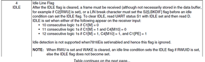

There is an idle line detection feature in Kinetis MCU.
When a frame of data is sent, the idle detection function will detect from the stop bit of the last data. When the10th or  the13th consecutive high levels are detected, it means that the data of the previous frame has been transmitted. At this time, UART generates an idle line interrupt, in which a data frame reception completion flag can be set, Then the main program can process the received data
UARTx_S1 :
