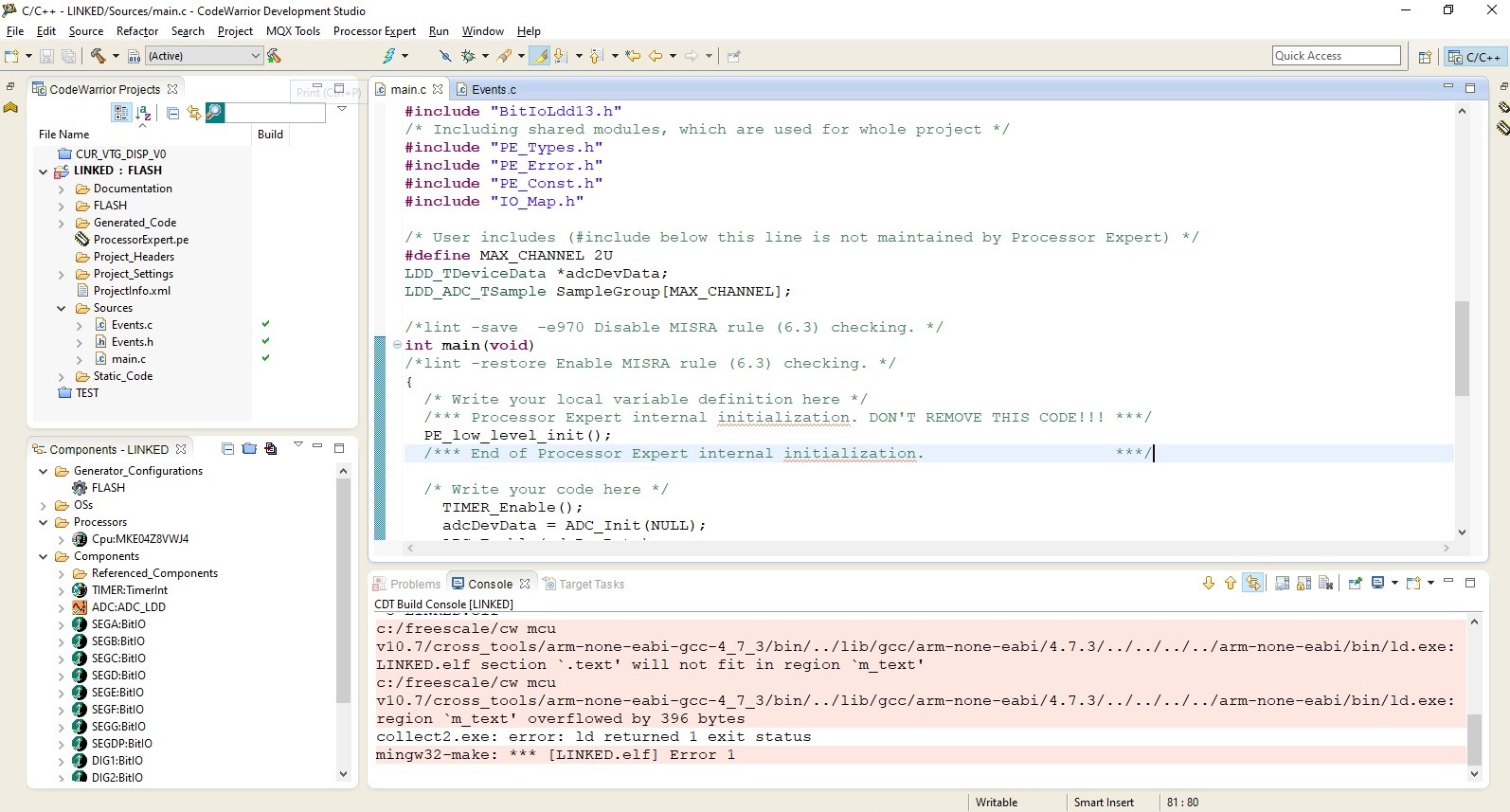

I'm using my own board of MKE04Z8VWJ4 (which is having 32-bit, Flash memory - 8KB, RAM - 1KB), when I'm trying to Initialize the timer and ADC components using Predefined functions (Shown in IMG003), it shows the error "region `m_text' overflowed by 396 bytes". Even I have not added my own code in the project yet.
          Someone on this community suggested code optimization setting for the similar problem. After changing the optimization level to "Optimize size(-Os)" above error is gone.
          But when i am trying to write my code (size 3K) it is showing same error again.
How to resolve this error??
Kindly go through Attached Images and Code.

As you have probably deduced m_text overflow means there is more code than there is Flash space for it.
Try upgrading to the recent MCUXPresso and SDK.  GCC 4.7.x is rather old.  There have been some improvements in optimization since then.  Also the newer SDK generates better code than Code Warrior did.
Ultimately a small part like the 04 may simply not have the capacity for the application at hand.

But without writing single line of code why it is showing code size of 6168 (You can see in the attachment)? I have only created components required for my Project. Out of 8K flash 6168 memory is consumed without writing single line of code.  am I doing something wrong in creating project?

In addition to using the -Os small model there are other options that can be added to the Makefile to reduce code further, if they are not already in the Makefile.
This is example from my own Makefile, the variables CFLAGS and LDFLAGS are likely to have different names in your Makefile.

CFLAGS += -ffunction-sections -fdata-sections
LDFLAGS += -Wl,-gc-sections,-u,main

As suggested by you I am trying my code on MCUXpresso and SDK. and size of Blank generated code is reduced as compare to Codewarrior10.X project.

You have to keep in mind that examples come with lots of things your might not aware of: startup code, library code, asserts, ...: they are there to make somewhat 'your starting point easier', but at the end you are responsible to get things in and out. Somewhat related: here is such a process with the SDK (not Processor Expert): https://mcuoneclipse.com/2019/08/17/tutorial-how-to-optimize-code-and-ram-size/
A single (unwanted) printf() might add several kBytes of code to your application. I recommend you have a look at your .map file to see what is using how much. As you can see with the above article, with the right knowledge and a bit of work with knowing what you do you can get a minimal 'blinky' down to a few hundred bytes.
