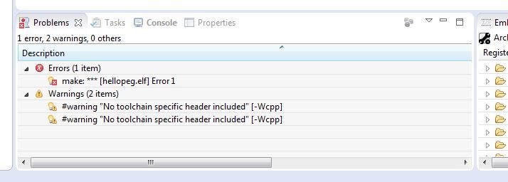

The Peg evaluation software that interfaces with our TWR-LCD, and our TWR-RGB-LCD boards need to be compiled and ran in KDS version 2.0.0.
The fix below is for the "PEGPLUS_evaluation_for_TWR_K70F120M".
If you load the firmware in KDS 3.0.0, you'll get these errors:
Here is what you'll need to do to fix them:
1. Import project into KDS 3.0.0:
     Start the “KDS Upgrade assistant”
          Use the following options:
o   Semihosting
support: nonsys (-specs=nosys.specs)
2.  Update the linker file:
Replace with the .ld file (attached)
OR
Modify the existing .ld file by adding the following line to the end of the .ld
file (inside the curly brackets)
PROVIDE ( end = . );
