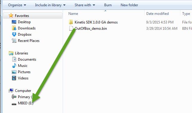

Hi, I seem to have an older version of the K64f board that was packaged without a usb cable in a brown slip box. It does not run a demo program out of the box. I remember seeing a webpage on how to reload  the demo programs and how to switch between them, but cannot find it now. Any help will be appreciated.

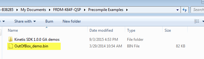

You can find the out of the box demo binary on the FRDM-K64F Quick Start Package:
The QSP can be downloaded from this link:
http://cache.freescale.com/files/32bit/software/board_support_packages/FRDM-K64F_QSP.zip
The FRDM-K64F should come with the mass-storage device (MSD) Flash Programmer OpenSDAV2 Application preinstalled so you only need to drag and drop the out of the box demo binary file to the MBED drive:
