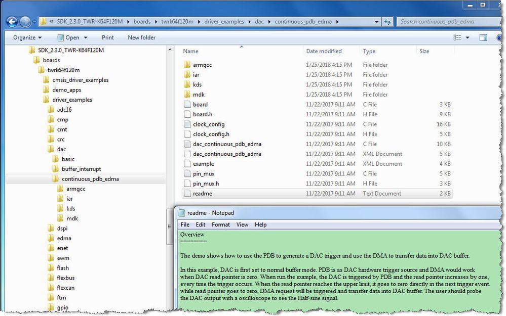

Robin_Shen
Hi Andy,
Please check if the dac continuous_pdb_edma example in SDK_2.3.0_TWR-K64F120M meet your needs.
That example can be found in SDK_2.3.0_TWR-K64F120M folder(For example: C:\SDK_2.3.0_TWR-K64F120M\boards\twrk64f120m\driver_examples\dac\continuous_pdb_edma)
You can download SDK_2.3.0_TWR-K64F120M package refer Generating a downloadable MCUXpresso SDK v.2 package.
Robin
