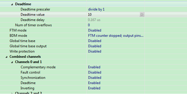

Hi Juan Nava,
      You can use the init_FTM component, in this component, you can set up the combine mode and dead-time like following:
      you can try it now!
     I wish it helps you!

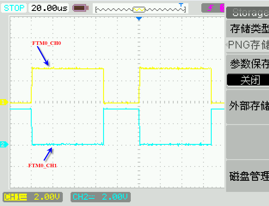

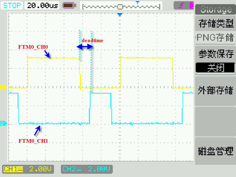

       I create a project, and test it ok, it use the Init_FTM component, and configure the FTM0_CH0 and FTM0_CH1 in combine mode, make the deadtime to about 10us.
       Please find my project in the attachments, it is based on the TWR-K70F120M.
       The test result as follows:
  Picture1:with no deadtime
  Picture2:with about 10 us deadtime
Wish my answer helps you!
