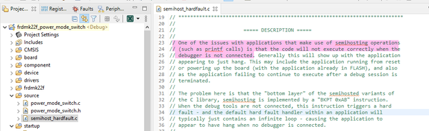

Semihost is an invasive debug technique that requires more additional flash and SRAM resources. Usually semihosting is not recommend for applications running on the field. Personally I would recommend using it only during a debug session, as it may provide a hard-fault when the application is running without a debug session. See this reference from the semihost hardfault file.
