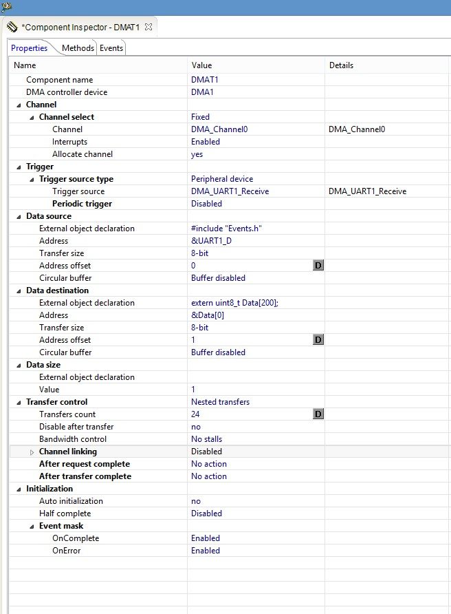

I am using K60, 100Mhz uc, CW10.6 with PE. I have configured DMA at UART. The data coming in the UART is of variable length and is in hex format. I am able to receive and parse the data of fix length but for variable length i am not able to do anything. I need your suggestion for going further and make this work.

DMA config
when the packet size is 24(i.e fixed data size) it is working fine.
In final run I have set this transfer count to 255 from 24

I tried DMAT1_SetTransferCount(dmap, 0);
but with this the total no. of data to be counted got changed and dma started flagging randomly.
I just want to reset the current value of the counter not the final value to be counted.
