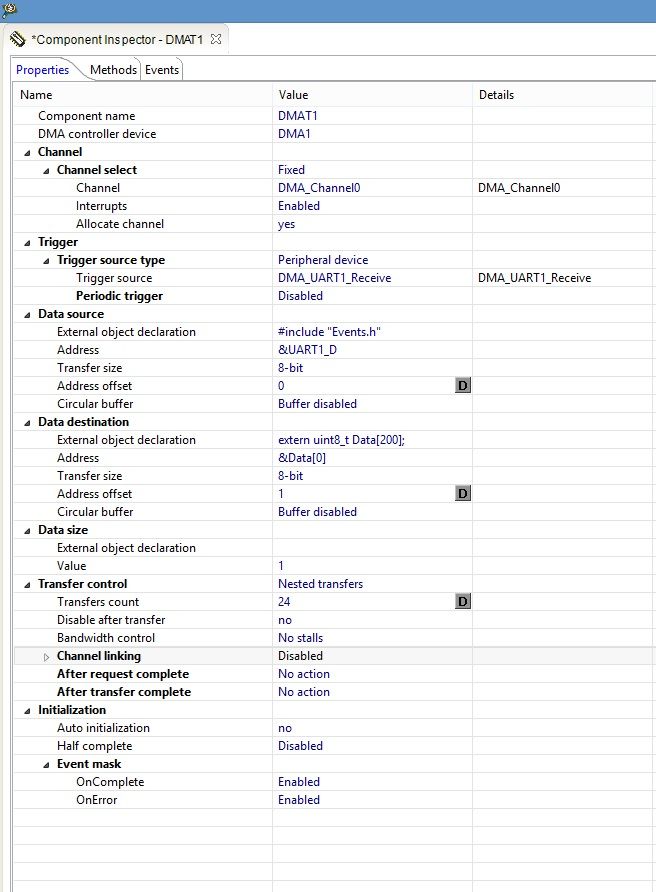

I am using K60, 100Mhz uc, CW10.6 with PE. I have configured DMA at UART. The data coming in the UART is of variable length and is in hex format. I am able to receive and parse the data of fix length but for variable length i am not able to do anything. I need your suggestion for going further and make this work.

What I have done is :
DMA config
when the packet size is 24(i.e fixed data size) it is working fine.
In final run I have set this transfer count to 255 from 24

jeremyzhou
Hi Amit,
I'd like to recommend a scenario to receive a variable number of data by DMA.
First, you should configure the transfer byte count=6 and set the DMA_TCDn_CSR[INTHALF],DMA_TCDn_CSR[INTMAJOR] bit to1. Then it will trigger a interrupt after DMA transfer the DATEA[2] to destination.
Second, in the interrupt function, check out the specfic number that the data contain, then adjust the byte counter that will be used for Scatter/Gatter Processing.
Third, if the variable number is less than 6, the interrupt can't happen again, as the major iteration count can't complete. so you can disable the DMA and handle the byte data that had received already.
However if the variable number is more than 6, the DMA will trigger Scatter/Gatter Processing to recieve the last byte data after it  transfered the 6 byte data to destination.
Hope this reply help.
