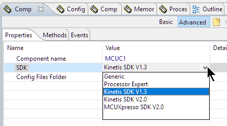

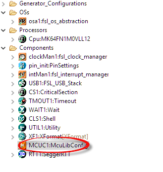

I am using processor expert with SDK 1.3 and KDS 3.2 on a FRDMKL82z.  The "stock" SDK components work without problems - however when I try to use the MCUonEclipse beans I get errors.  As I am new to processor expert I am unsure as to how to fix them.  For example, when I include the RTT1 segger bean I get a whole bunch of "undeclared" errors, such as "ERR_OK", "ERR_FAILED" "TRUE" "FALSE".  What am I doing wrong?

In the McuLibConfig component,
you have to select which SDK you are using:
see as well Tutorial: Blinky with Kinetis SDK V1.3 and Processor Expert | MCU on Eclipse  (but not that the KinetisSDK component has been replaced by the McuLibConfig one).
I hope this helps,
Erich
