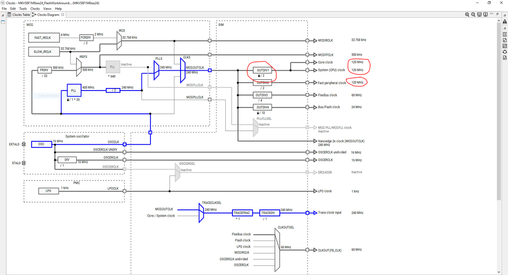

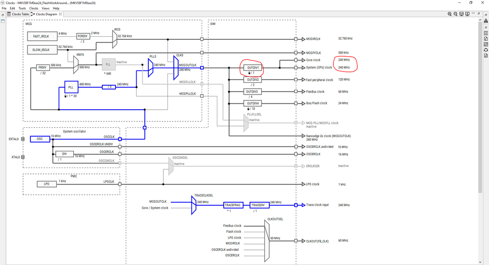

I have made two configurations with "MCUXpresso Clock Config Tools" that allow you to switch from HSRUN to RUN without changing frequency to critical engine peripherals (PWM & FTM). This only changes the frequency of "Core Clock" and System Cpu Clock: the latter also affects the HSADC clock, but this should not cause problems as only a slower conversion time is obtained for some ms. However with this configuration you can also use nanoEdge without limitation.
The trick is to have the MCGOUTCLK clock at 240 MHz and to switch only the OUTDIV1 divider to change the core clock, while OUTDIV2 is always set to "/2".
For the most part of the time the MCU works in HSRUN with 240MHz CPU and 120MHz Fast Peripheral Clock (so at maximum performance) with this configuration:
When the MCU has to program or delete the Flash Memory, it switches from HSRUN to RUN (normal run), keeping all the fast peripherals at 120 MHz but only reducing the "System Clock" from 240 MHz to 120 MHz, changing the OUTDIV1 divider from / 1 to / 2: this way we respect the features of Normal Run:
Apparently (according to the MCUXpresso Config Tools) we should be able to have the Fast Peripheral Clock frequency equal to that of the System (CPU) Clock. However, reading the reference manual in paragraph 6.3 page 102 we find that "The Fast Peripheral clock frequency must be an integer divide or multiple of the System (CPU) clock, that is, x2, x3, x4, or divide by 2/4/8".

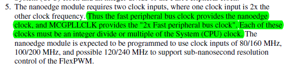

  1. As Mark has rightly pointed out, and as it is actually written in two different documents (see above) it is written that: "Thus the fast peripheral bus clock provides the nanoedge clock, and MCGPLLCLK provides the "2x Fast peripheral bus clock". Each of these clocks must be an integer divide or multiple of the System (CPU) clock.". Therefore, according to the documentation, it would not be possible to make my configuration in Normal Run mode and use the nanoEdge because System Clock is identical to Fast Peripheral clock.
  2. Also in reference manual in paragraph 6.3 page 102 we find that "The Fast Peripheral clock frequency must be an integer divide or multiple of the System (CPU) clock, that is, x2, x3, x4, or divide by 2/4/8".
Where's the mistake?

So in my Normal Run configuration between System Clock (120 MHz) and Fast peripheral clock (120 MHz) we can consider that we have an /1 or x1 ratio, which means an integer, so it is acceptable. Thank you. Now I understand.
Instead, what can you say about what Mark had written:
From what is written in the data sheet if we want to use the microEdge we can not set the system clock equal to the fast peripheral clock: it must be half. So during Normal Run it would not be possible to use microEdge as both the two frequencies are 120 MHz.

Ah, I missed that note the first time.  That is an error.  Instead of the system clock there, it should be the MCGPLLCLK. If I remember right, there was a previous devious with this module and that module did use the system clock for the Nano-edge 2x clock (but KV5x is not designed this way).  So that's probably a carry over from a previous device, which is a mistake.  I will make sure to get this updated in the next revision of our datasheet.  Thanks for pointing that out.

 So your fast peripheral can be operating at 240 MHz.
Maybe! If this were true, I would be happy! It would be the right operating situation: cpu clock and peripheral clock at the same maximum frequency (which is the situation that some of your competitors make with ARM and that you do with the DSC).
Unfortunately I think what you wrote is a lapse: maybe you intended to write that the System Clock will work at 240 MHz (not the fast peripheral clock). :smileywink:

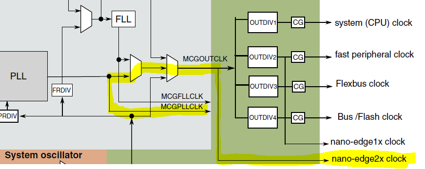

Looks like you got lucky that the restriction was an error!
Looking at the clocking diagram:
one sees that the x2 nano-edge clock is indeed not the system clock but the MCGOUTCLK, which happens to be equal to the MCGPLLCLK in the general high speed case.
If this diagram is exact it is thus the MCGOUTCLK that needs to be twice the speed of the fast peripheral clock, which is always the case as long as OUTDIV is set to 2.
Mark

From the data sheet:
This looks to be the hard restriction that needs to be considered.
One often finds some ambiguous waffle in the user manuals but the content of the data sheets is generally dead-serious...
Mark

Yes you are right. In the data sheet, it is written.
This limitation (if true) is also found in the "Reference Manual Rev.4" (p.104):
So summarizing, these may be the points that would not allow me to do my trick:
  1. If it is mandatory to have between the System clock and the Fast Peripheral Clock the ratio of /2, /4 or x2, x4.
  2. If you use nanoEdge question is whether it is true the limitation that we wrote a little higher.
