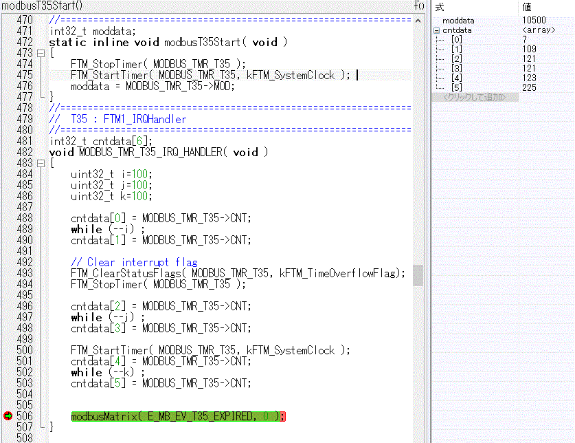

jun1
Contributor V
Thank you for your reply.
I checked with the test code.
I set 10500 to MOD. --- moddata
When an interrupt is generated, CNT of FTM1 becomes 0. --- cntdata [0]
If the timer is not stopped, the count continues. --- cntdata [1]
After the timer stops, CNT remains unchanged. --- cntdata [2] / [3]
Looking at the value of CNT after the timer starts, it seems that it starts counting from the previous value. --- cntdata [4] / [5]
So, the question is, is there a way to set CNT = 0 when the timer starts?
My idea is to write 0 directly to the CNT at the start of the timer.
Please let us know if there is a more appropriate method.
From there, it is natural, but if the timer does not stop, it continues counting.
Thank you.

kerryzhou
Hi jun yamada,
  Your test result is correct, please know one key point: The counter will be cleared when the counter is overflow.
  That's why your cntdata[0] is nearly 0. After the overflow happens, the counter will counter again, that's why your other cntdata also has the data.
   If you want to clear the counter, you can set CNT = 0  directly.
  Reset clears the CNT register. Writing any value to COUNT updates the counter with its initial value, CNTIN. If it is FTM0/1, it should be updated to 0.
  But please note, even you write CNT=0, the counter will go on counting, if you want the counter stop, you can just disable the FTM  clock.
