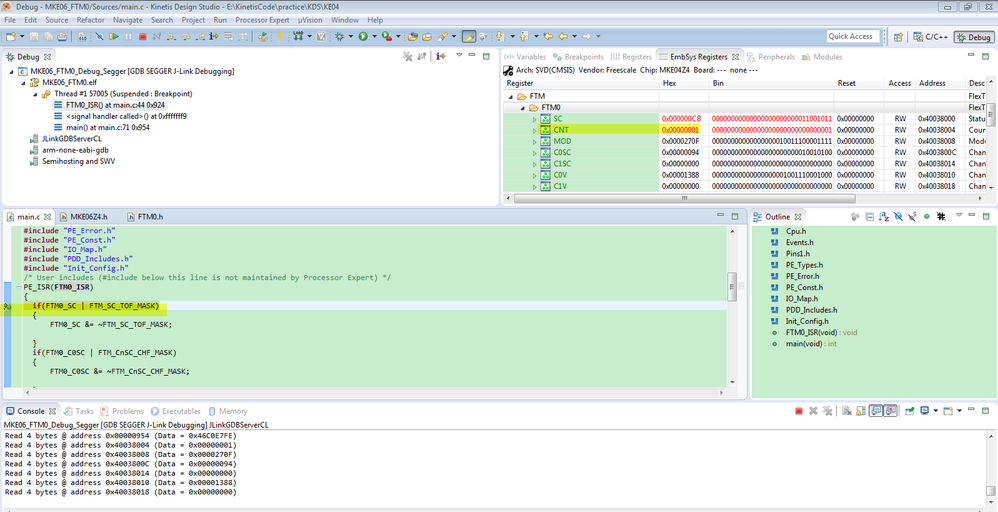

kerryzhou
Hi Jun,
   Thanks for your updated information.
   Yes, you are right!
   MKE04 FTM0/1 doesn't have the CNTIN register, but I have tested the FTM0 overflow function, after the counter overflow happens, the CNT will be reset, please check my test result:
I enable the FTM0 timer overflow interrupt, when the overflow happens, the CNT is cleared.
I don't know how you test it, I think you also can enable the overflow interrupt, then debug the code, and add the break point in the interrupt, when you enter the interrupt, you can check the CNT data.
I am using the KDS PE to create the FTM0 code for KE04, I also attach the code for your reference.
If you still have questions about it, please kindly let me know.
Kerry
3,400件の閲覧回数
jun1
Contributor V
Thank you for your reply.
I checked with the test code.
I set 10500 to MOD. --- moddata
When an interrupt is generated, CNT of FTM1 becomes 0. --- cntdata [0]
If the timer is not stopped, the count continues. --- cntdata [1]
After the timer stops, CNT remains unchanged. --- cntdata [2] / [3]
Looking at the value of CNT after the timer starts, it seems that it starts counting from the previous value. --- cntdata [4] / [5]
So, the question is, is there a way to set CNT = 0 when the timer starts?
My idea is to write 0 directly to the CNT at the start of the timer.
Please let us know if there is a more appropriate method.
From there, it is natural, but if the timer does not stop, it continues counting.
Thank you.
