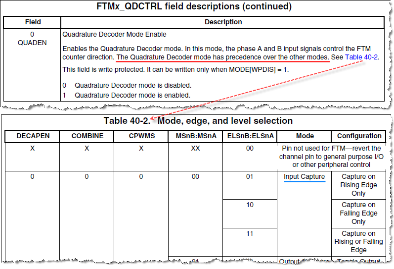

I am using an FTM module on the K64F as a quadrature decoder to keep track of the position of an optical rotary encoder. I would also like to time-tag the edges of of the A/B quad channels using FTM Input Capture, so that I can more precisely calculate rotation speed. Is this possible with a single FTM module, or will I need to physically connect the quadrature signals to two separate physical pins, each one monitored by a separate FTM module? The first module would continue to act as the Quad Encoder (say FTM2), while the second module (say FTM3) would act as a free-running timer responsible for the periodic interrupt, and the input capture.

where t_current and t_previous are recorded using input capture of the quad channel pulses on FTM3.

Hi Andy Berger,
The Quadrature Decoder mode has precedence over the other modes.
So you need to physically connect the quadrature signals to two separate physical pins, each one monitored by a separate FTM module.FTMx_QDCTRL[QUADEN].png
Robin
