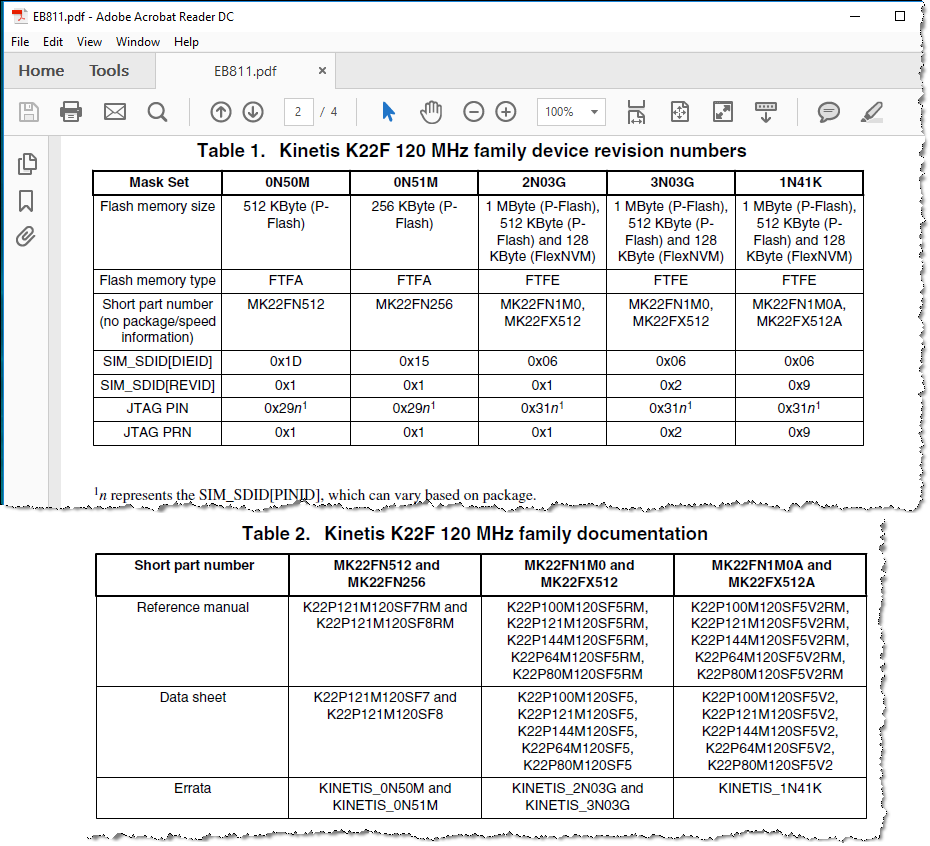

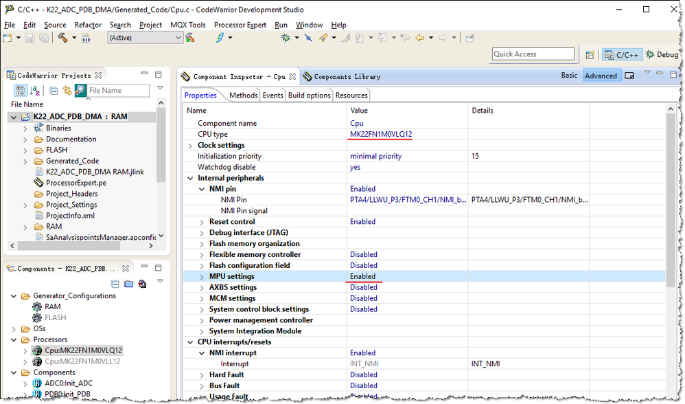

Robin_Shen
According to the project setting, MK22FN1M0VLQ12 was selected. Please make sure you are using this Part Number, otherwise different hardware will cause hardfault. (Notice Kinetis K22F 120 MHz Family Mask Sets and Revision Numbers)
For example: I only have FRDM-K22F(MK22FN512VLH12) and TWR-K22F120M(K22FN512VDC12), so it will run into hardfault due to lack of MPU.

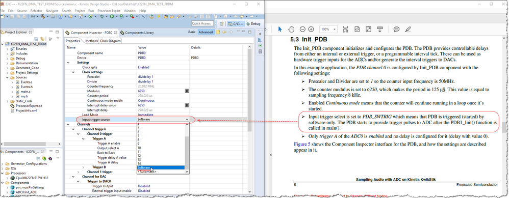

Robin_Shen
Input trigger select need to be set PDB_SWTRIG which means that PDB is triggered (started) by software only.
Then you are able to get the DMA interrupt.

dhruvonline
Hi Robin,
Thanks for the suggestion. Now I am getting the DMA interrupt and it is working. But when I debug multiple times, after some time it is going to PE_ISR(UnhandledInterrupt);
