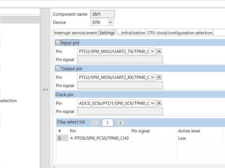

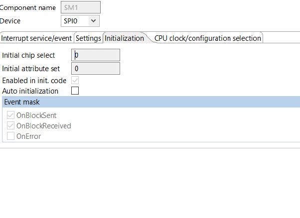

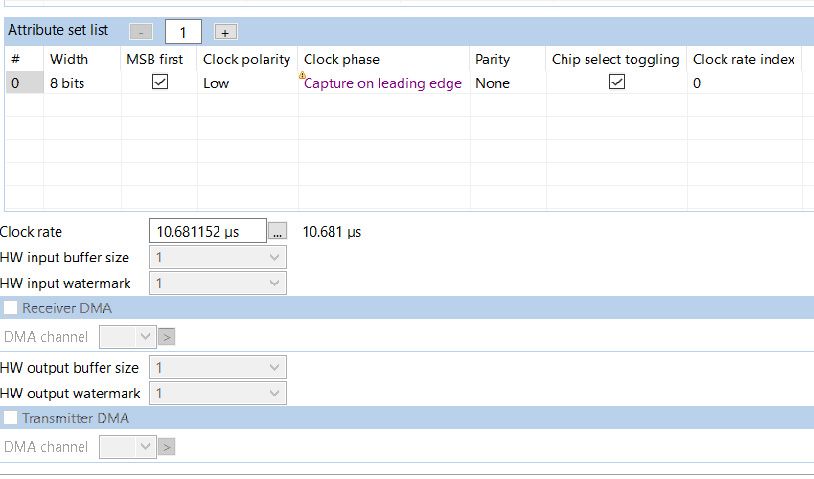

I try to make a connection between ADXL345 accelerometer and KL25Z via SPI.
I have connected the ADXL345 like that:
PTD0 SPI0_PCS0 to CS
PTD2 SPI0_MOSI to SDA
PTD3 SPI0_MISO to SDO
PTD1 SPI0_SCK  to SCL
Next I have used the SPIMaster_LDD component
LDD_TDeviceData *masterDevData;
uint8_t Adresse,Value,Error;
  PE_low_level_init();
  masterDevData=SM1_Init(NULL);
  Adresse=0x00+0x80;
  Error=SM1_SendBlock(masterDevData,&Adresse,1);  //to get value at adress 0x00
  Error=SM1_ReceiveBlock(masterDevData,&Value,1); //I should received 0x5A but I received 0x00
Any idea?
