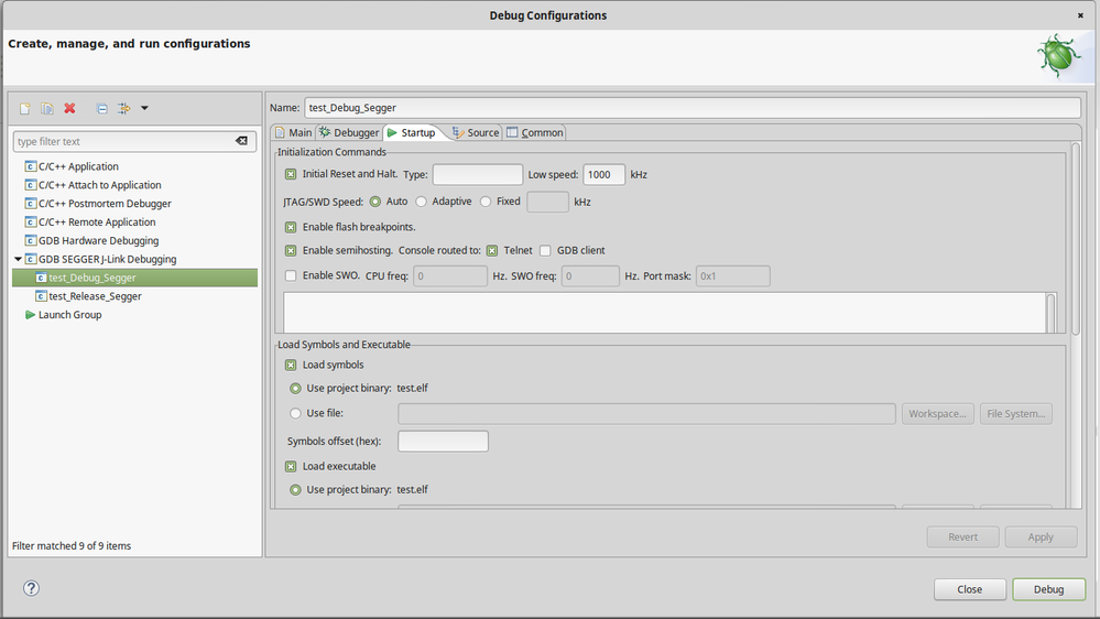

Also I've installed KDS setup wizard addon to Eclipse, I'm able to build the project but when I try to debug, debugger runs but the code is not running on the board. Is there any setting that I need to change in the debug configurations. My current configuration is attached.

Your settings look ok.
