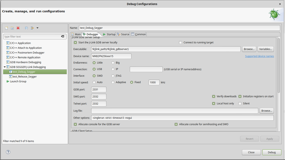

Also I've installed KDS setup wizard addon to Eclipse, I'm able to build the project but when I try to debug, debugger runs but the code is not running on the board. Is there any setting that I need to change in the debug configurations. My current configuration is attached.
Screenshot from 2016-07-09 23_31_37.pngScreenshot from 2016-07-09 23_31_53.png
2,932 Views
BlackNight
Your settings look ok.
