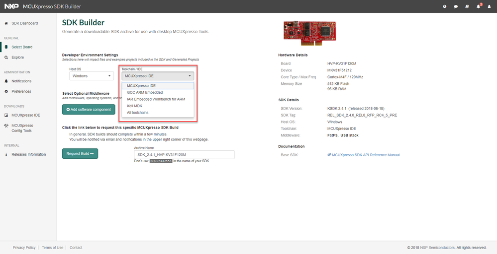

Hello everybody,
I have currently a project running with gcc and KSDK 1.3 who compile and runs perferctly. I don't use any IDE to work and compile that project.
I want to update the KSDK version to the latest one (2.4) but i can't have something running even with trying to adapt the Makefile. If i remember well, i used KDS to compile the platform library in the KSDK 1.3, then i just added it in my project git repository and in the Makefile.
For the new version i don't know how to proceed. Is there any documentation which explain how to do because i am really lost?
Thank you in advance,
Thomas

Hello Thomas,
When you build your SDK with MCUXpresso SDK builder you have the option to select your Toolchain/IDE. You can select GCC ARM Embedded or MCUXpresso IDE. MCUXpresso IDE is our newest IDE and it's the replacement of KDS.
I highly recommend you to use MCUXpresso IDE. In the User guide you will find all the information you need on how to work with the SDK.
Hope it helps!
Victor.
