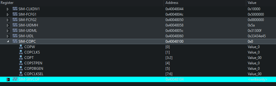

I am trying to implement a watchdog timer in my code, and I think the register is being addressed before I use the init function, but I can not find where.  I was able to find the disable in the system_MKL17Z644.h file:
#ifndef DISABLE_WDOG
  #define DISABLE_WDOG  0
#endif
However when I set the define to 0 I get a working watchdog timer, but not with the settings that I am sending.  I am trying to set the debug bit, and the long timeout bits as I would like as long of a timeout as I can set to start with, but when I read the register after I write to it, I only see that COPT has been set to 11, all other bits are 0.  This is read through a PE Micro debugger.

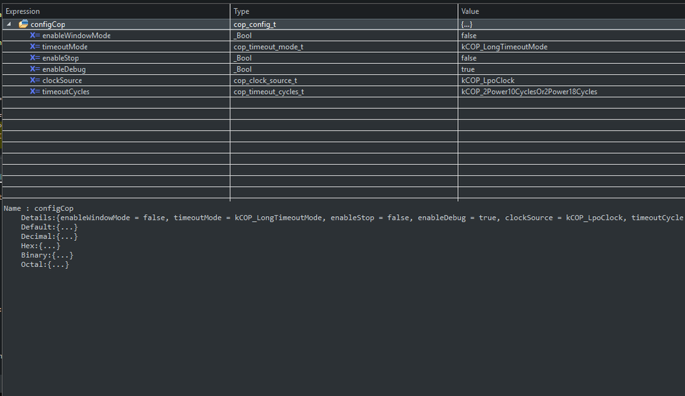

For reference, here is a sample of what i cam doing to enable the COP, my actual code is way to big to just paste in.
#include "fsl_cop.h"
#include "fsl_rcm.h"
cop_config_t configCop;
COP_GetDefaultConfig(&configCop);  //Here is where I setup the long delay and debug bits
COP_Init(SIM, &configCop);
No matter when I check the register, I see the same settings, that is at the top of main, right before and right after the init().

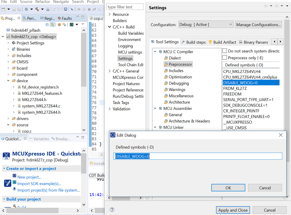

I agree with you, DISABLE_WDOG must be zero in order to get a functional cop. To do this please disable it from the Preprocessor macros at: properties- > C/C++ Build -> Settings -> MCU C Compiler -> Preprocessor

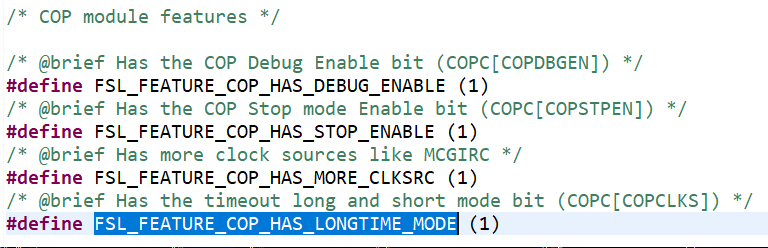

Please check that the macro FSL_FEATURE_COP_HAS_LONGTIME_MODE is defined with one if this macro is not defined to 1 the value loaded to the COP registers may vary from your desired values.

Based on the sdk example I suggest you set the macro DISABLE_WDOG to 1. Also please check that the macro FSL_FEATURE_COP_HAS_LONGTIME_MODE is 1. Those 2 macros are very important for the COP init. You can find these macros at "MKL17644_features.h"

Won't this address the timer and make it so that I can not use it?  I only ask because when I do set DISABLE_WDOG to 1 and go to init the COP I get a non functional COP.
The configuration from get default config looks correct:
However the Init does not change the register values:
I will keep digging into it, but I am a bit lost.

umlengineer
I did not see that line for the watchdog in the settings so I wrote it in, but it solved all of my issues.  I guess commenting out the line in code is not the same :smileyhappy:.
