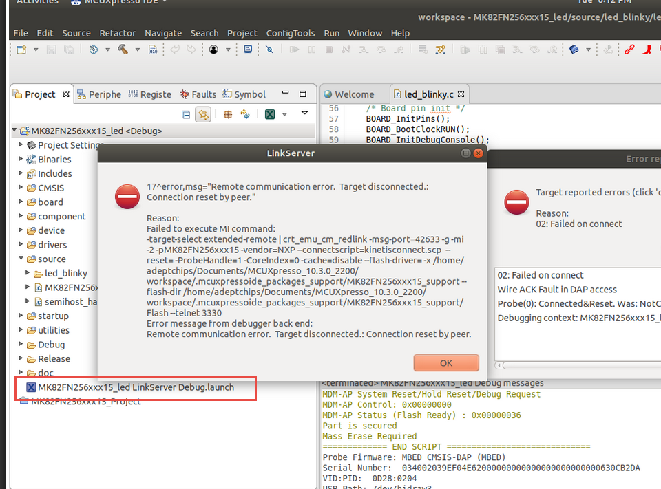

I'm new to the FRDM-K82F board. I'm using the MCUXpresso IDE to flash the binary to this board.
I'm facing the below problem while flashing the binary to the board. Please find the attached image.
2-3 times i tried and i was able to flash with the same error, but now i'm not able to flash at all, stuck with the same error.
connection failed - Nn(05). Wire ACK Fault in DAP access.. Retrying
Using memory from core 0 after searching for a good core
Failed on connect: Nn(05). Wire ACK Fault in DAP access
Connected&Reset. Was: NotConnected. DpID: 7270230A. CpuID: 00000000. Info: <None>

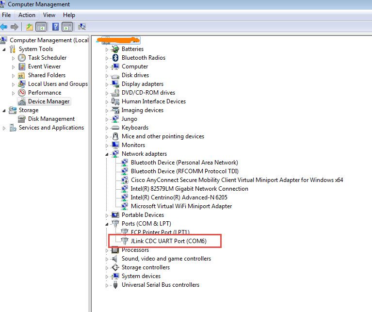

5. Power off the board and power on it again, check the device management:
It means you already change the firmware correctly to JLINK, then you can use the JLINK as the debugger.

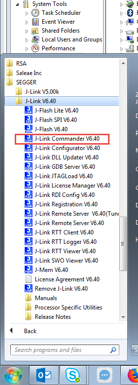

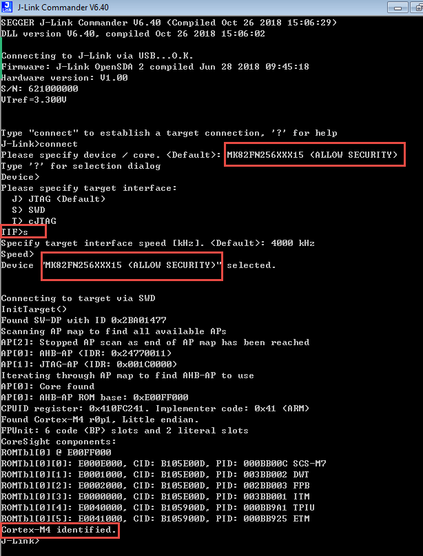

6. Please open the JLINK commander window
You can find, the above test result from my side, I can find the Cortex-M4, please also check it on your side.
If you can find the core, it will don't have the big problem.

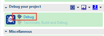

   You have the MCUxpresso IDE project, you don't need to flash the binary directly.
   At first, please delete the following .launch:
Then build the project again.
Then click the debug button:
and enter debug mode again.
Kerry
15,149 Views
venkatesh_godug
Hi Kerry Zhou,
I have followed the way which you mentioned, but when i clicked on debug symbol, we need to create the launch file specifically, so i used option as Debug as-> 2. MCUXpressoIDE LinkServer option, then debug launch file is getting created again and same issue is reproducing.

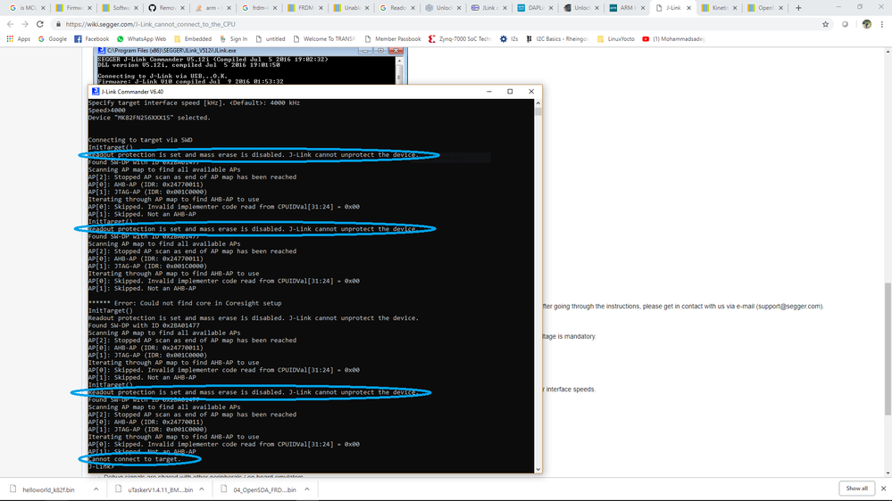

After trying everything during trials of fixing flashing problems, i'm end up with boot loader lock issue, now i'm unable to connect to the target at all. Please see the image below
what does it mean, does it mean boot loader got locked ? if so how to unlock and flash the program.

venkatesh_godug
Hi Kerry Zhou,
Specifically I did not change any configuration at any address, I just flashes multiple times .bin file multiple times that's it.
And moreover I'm unable to unlock it, I attached the image in previous Replay kindly check it.
Now the first thing is device is not getting connected so I'm unable to unlock it, getting error message as
"Read out protection is set and madm erase is disabled. J-Link cannot upgrade the device".
I tried flashing openSDA bootloader multiple times but no result.
So what does that issue means exactly, kindly provide solution.

kerryzhou
Hi Venkatsh g,
    Thank you for your updated information.
    From your result, unfortunately, you secure the chip, and the mass erase bit is also disabled, it means that your chip is secured to the highest level, normally, this mode can't be unsecured any more.
    But, from your attached picture, I find you select the device as "MK82FN256XXX15", not "MK82FN256XXX15 (ALLOW SECURITY)", this method normally won't allow the security. So I think you also can try to select the chip as "MK82FN256XXX15 (ALLOW SECURITY)", then after the connect failed, input: unlock kinetis
   Just try it again.
   If this method also can't work, from my own viewpoint, one way for you, get a new K82 chip, replace your on board K82 chip to save your board.
Wish it helps you!

venkatesh_godug
Hi Kerry Zhou,
I tried unlocking MK82FN256XXX15 <ALLOW SECURITY> but I am getting Timeout error. I am unable to unlock ALLOW SECURITY module as well.
First of all, I would like to know, how the chips got secured. Since I have not written anything in the firmware, its just led blinking, how chip moved to highly secured mode.
How to avoid this issue.
venkatesh
15,149 Views
kerryzhou
Hi venkatesh g,
   It's a sad result, your chip is dead which is secured to the highest level, no one can unlock it now.
    Just as I have told you: get a new K82 chip, replace your on board K82 chip to save your board.
Kerry

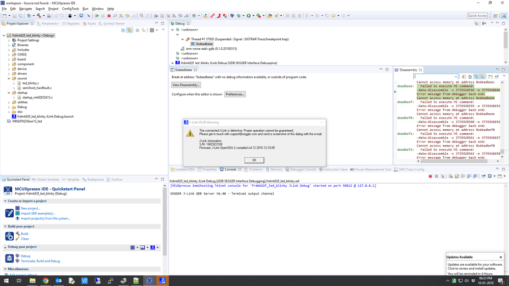

Hi Kerry Zhou,
I was unable to make it resolved for Ubuntu PC. Probes are not getting available after installing the Jlink drivers in ubuntu.
And one more thing, while flashing the binary(in windows pc), board is getting flashed but i'm getting an error like
deadbee1: Failed to execute MI command:
-data-disassemble -s 3735928551 -e 3735928583 -- 3
Error message from debugger back end:
Cannot access memory at address 0xdeadbee6
I don't know what is this error says exactly.
And sometimes after flashing the binary, control is hitting the ResetISR function, but it should supposed to point at main() function.
I'm just trying to flash the led_blink example program which I had imported from the SDK.
I have tried different examples as well but getting the same error.
Kindly suggest me know the solution.
