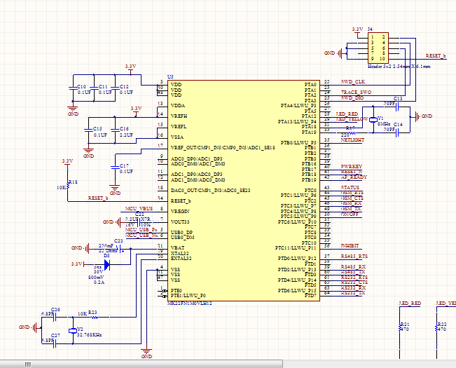

4,621件の閲覧回数
Jorge_Gonzalez
Hello Handy Chandra:
The reset pin oscillating is expected in new/unprogrammed parts.
Can you show the SWD connection schematics? SWD_DIO line must have a pull up.

handychandra
Here is the schematic of SWD Connection. I have tried adding pullup on SWD_DIO and pulldown on SWD_CLK on the PCB, but it is still not working.
None of the methods on your link earlier worked either.

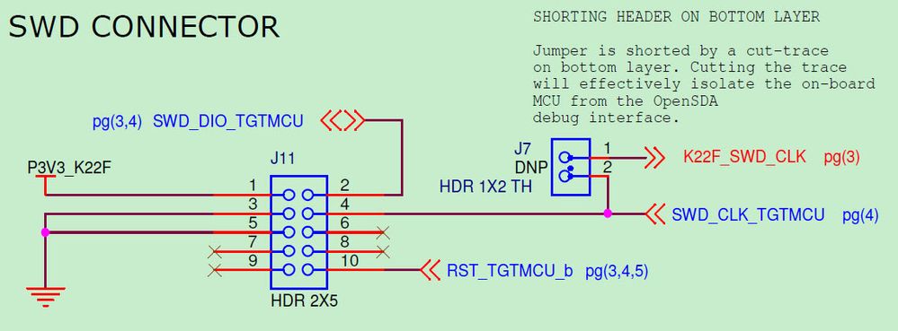

Hui_Ma
Hi Handy,
Could you tried to use J-Link tool debug your designed K22 board? Could not work?
Below is FRDM-K22F120 board SWD interface schematics for your reference:
Wish it helps.
best regards
Ma Hui

handychandra
Hi Ma Hui,
Yes, the swd connection is about the same, except for pin 9 connected to gnd and pin 6 connected to tdo.
I have tried two mcu and both of them fail at debugging. Yesterday, i tried the third mcu, and suddenly i could debug it !. I don't know what went wrong with the first two. The pcb is still the same with the same connection with pullup on dio and pulldown on clk.
4,621件の閲覧回数
Hui_Ma
It looks like some electron noise affect SWD communication. So customer could consider to add 10uF bypass capacitor to K22 VDD power line.
