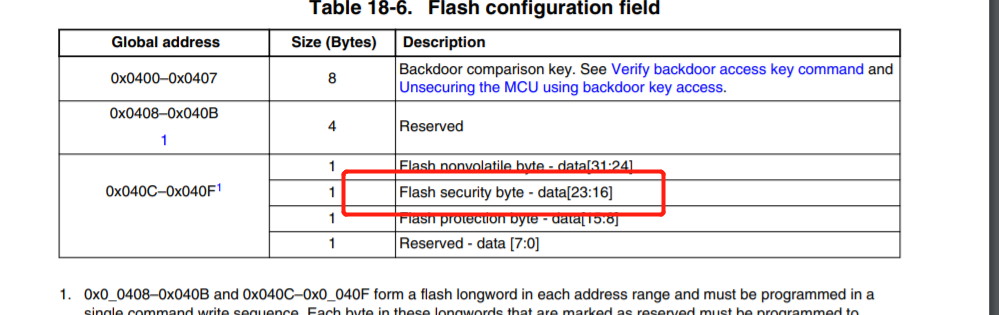

the security data = 0xBF;

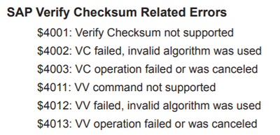

the program is error , Cyclone LC display the 4003 err  As shown below:

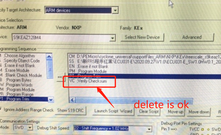

I  Set the Cyclone LC , delete the verify checksum.the program is ok.
I want to know if my operation is correct and if there is a risk,?

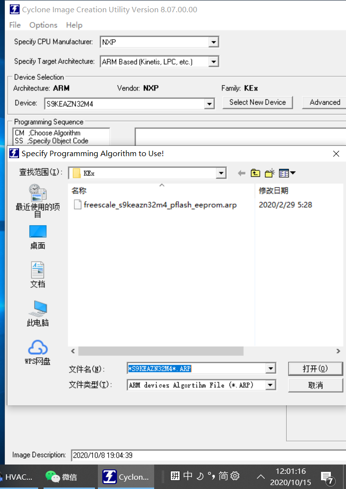

I use the MCU S9KEAZN32 also use the security function, but it don't have the Error. why?

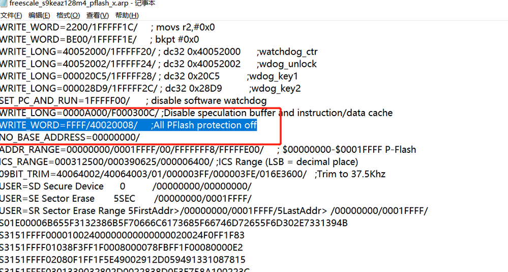

I think the reason of this error is this section right here:
The left one is the KEA128 and the right is the KEA32.
This command mention that will unsecure the device but the 4002000B address doesn't match with the protection register. Try changing it for the one in the KEA32.

HI:
      I edite the s9keaz128's arp file  like the picture.   but the error is same

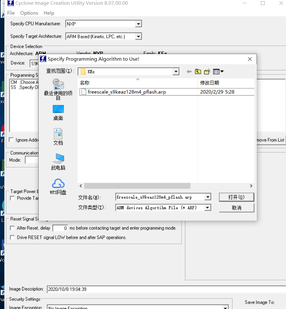

Could you try using any of the other two algorithms?
freescale_keaz128m4_pflash.arp
freescale_ke06z128m4_pflash.arp
Alexis Adnalon
4,224 Views
xiabin
I USE freescale_keaz128m4_pflash.arp ,The Error is same

I think this last instruction is trying to access the memory when is secured so that's the reason this command is failing, the error code mention that the operation failed or was canceled.
The strange thing is the SKEA32 pass this instruction correctly, are you using the same script?

the clclone  lc  setting in  S9KEAZ128 and S9KEAZN32 .  the other setting is same
