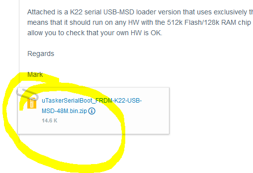

mjbcswitzerland
Specialist V
Attached is a K22 serial USB-MSD loader version that uses exclusively the IRC48M for processor and USB control. This means that it should run on any HW with the 512k Flash/128k RAM chip part (no external clock speed dependencies) and allow you to check that your own HW is OK.
Mark
12,646 Views
aune
Ah the settings were in the FMC registers so was fixed on flash controller, not crossbar switch :smileyhappy:
Where is the file ? I cannot see it ?
12,646 Views

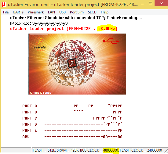

mjbcswitzerland
Specialist V
You should see the file attached in the post as long as you are logged in - if you don't you may be using an incompatible browser or have some other problem.
You can also download it from http://www.uTasker.com/temp/uTaskerSerialBoot_FRDM-K22-USB-MSD-48M.bin
I set up for the 48MHz clock for everything:
Mark
