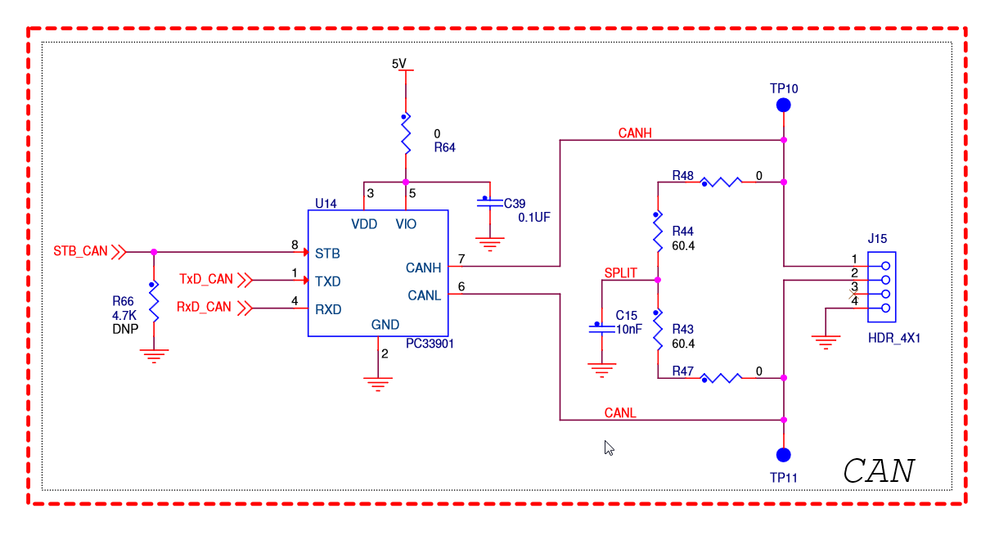

     From your description and the code which you are using, your problem is mainly caused by the MC33901 STB pin controlling.
     Just as MC33901 datasheet said: STB is the input pin to control the device mode. When STB is high or floating, the device is in Standby mode. When STB is low, the device is set in Normal mode.
    So,  if you want to make the MC33901 works in normal mode, you need to give a low signal to STB.
    Because our TRK-KEA128 have several vesions, some versions connect the STB to ground in the hardware, but some versions need to control the STB by KEA128 with pin PTG0. You can check your board SCH version which you can find it from the back of your TRK-KEA128 board, eg SCH-28200 REVD(the newest version), it means you need to refer the schematic version D. This version need to control PTG0 as low to make MC33901 works in normal mode.
    I check your code, your code didn't control pin PTG0, that's why you always get 0.5mv in CANH and CANL.

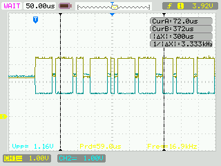

  After the modification, you will find your CANHand CANL voltage is correct, my test result is as follows:

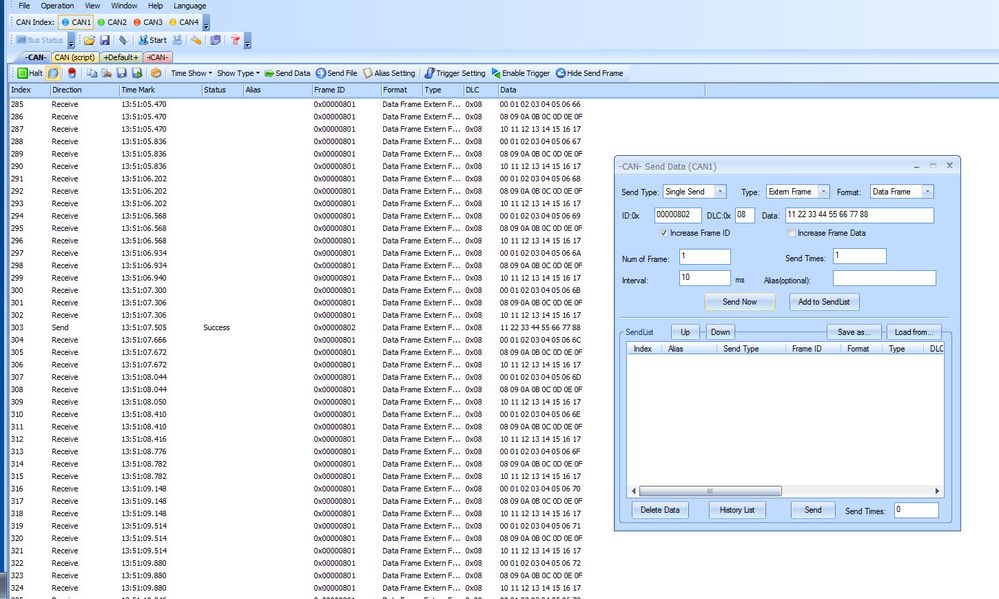

Beside, I also attach another MSCAN project for your reference, this project can directly work ok on your TRK-KEA128.
Follow picture is the test result of Can_test project, the baud is 100Kbps.
Wish it helps you!

Please check below schematics about TRK-KEA128 CAN PHY chip PC33901(MC33901):

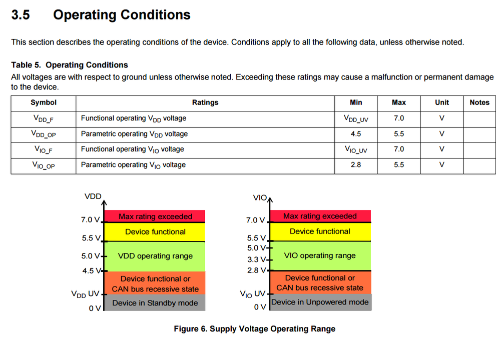

The P(M)C33901 CAN PHY chip operation voltage is 5V, more detailed electrical specification info please check here.
Wish it helps.

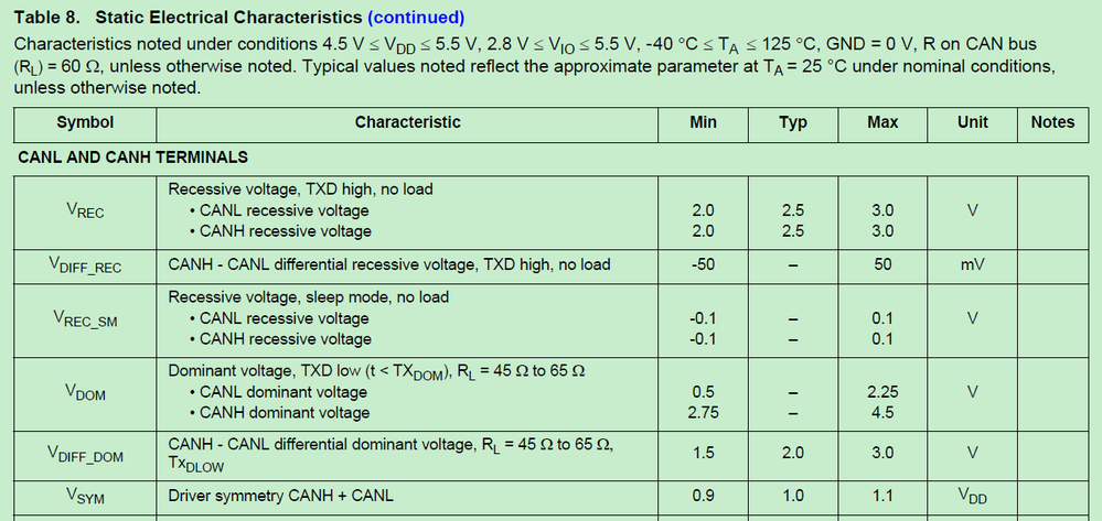

The TRK-KEA128 board using MC33901 CAN_H and CAN_L electrical characteristics please check below table:
You mentioned the CAN_H and CAN_L voltage is 2.5V, that is normal CAN bus recessive voltage.

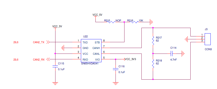

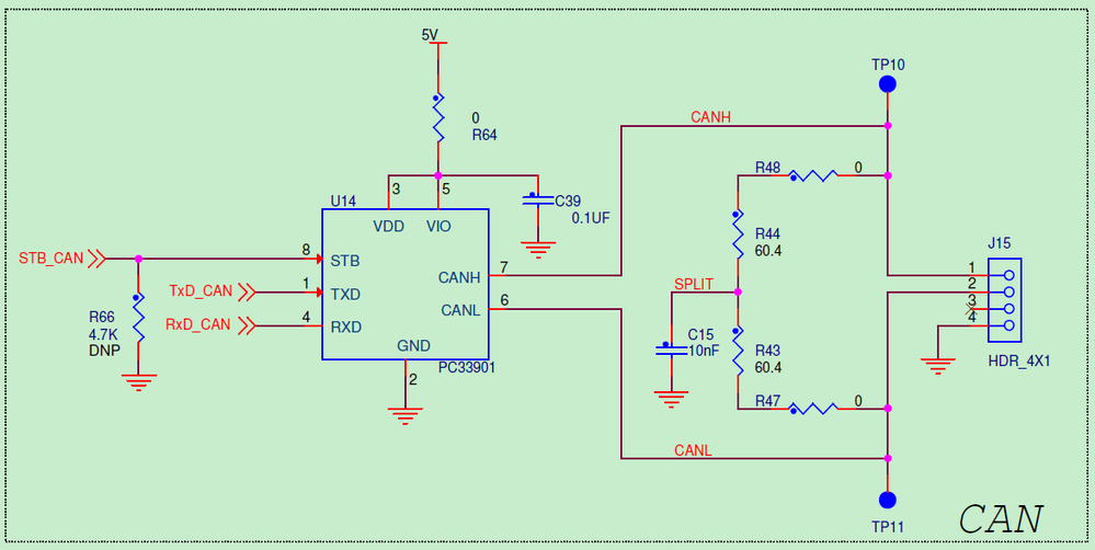

Please find the schematics of TI hercules tms570ls3137 board below
As per the electrical characteristics of TRK-KEA128, the voltage should be 2.5v on CANH and CANL pins in recessive state but when I measure it is only 0.5mv.

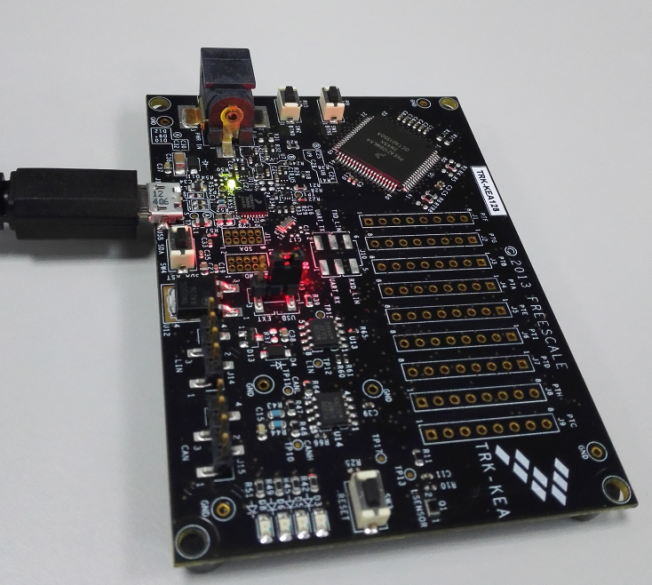

The TRK-KEA128 5V power could get from USB VBUS power, the Jumper J13 need shunt 1-2, more detailed info please check below picture:
Customer can connect USB port J16 provide power to the TRK-KEA128 board.

1. With the new development board, when powered up using USB,  4 LED's were blinking by default. I measured the voltage at J15 CANH(pin 1)/CANL(pin 2). It showed 0.5mv.
2. I guess CAN module is in sleep mode. That might be the reason for showing only 0.5mv.
3. So I flashed the code as given before(I have attached the code) for testing the CAN controller. The voltage measured is 0.5mv itself (no change from the previous reading). The voltage measurement is without connecting to CAN bus.
Observation: The CAN transciever chip MC33901 pin 8 (STB) is high which means the CAN transciever is in Stand by mode.. How do I switch to Normal Mode??

I guess you are using Rev D TRK-KEA128 while Hui was working on REV B, there is some difference between these two version, REV D uses PTG0 pin to control the STB of MC33901, while REV B ties it directly to GND, so you have to set PTG0 as GPIO output function and set it to low, so that it makes MC33901 in normal mode.

Thanks Kan, Jingjing. Finally it worked.
