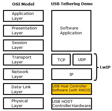

This project implements the RNDIS protocol on the top of the USB Host Stack and in the bottom of the LwIP (TCP/IP stack). When a cellphone is connected to a freedom board, it acts as a USB device and the Freedom board acts as a host.

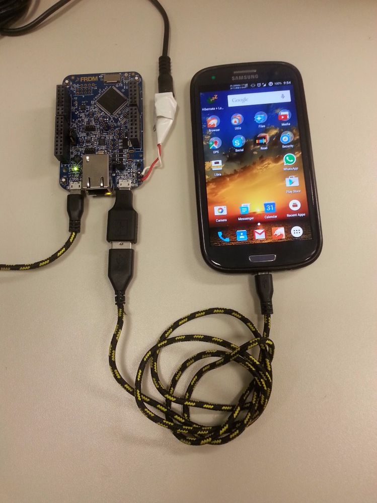

* Cellphone connected to a FRDM-K64F providing internet connection to the board
The user can design his own software in the top of the TCP/IP stack (LwIP) like if it's connected through an ethernet cable.

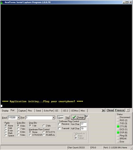

With the application flashed, open a Serial terminal with 115200kbps, 8N1 for the CDC interface of OpenSDA.When the board starts, it will display:

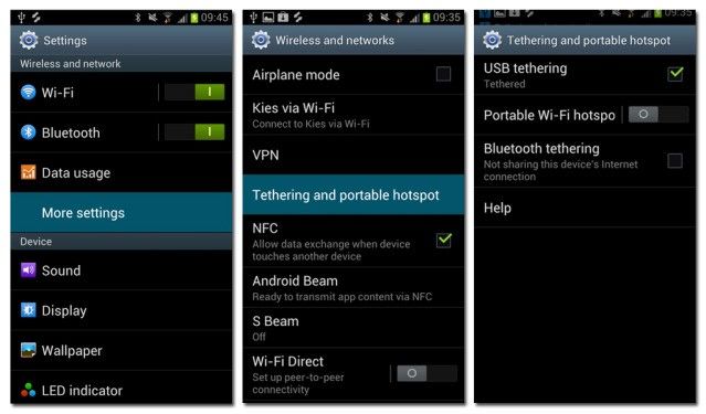

Connect your cellphone in to the USB of the MCU. After connect the phone turn on the USB tethering feature and wait some seconds:

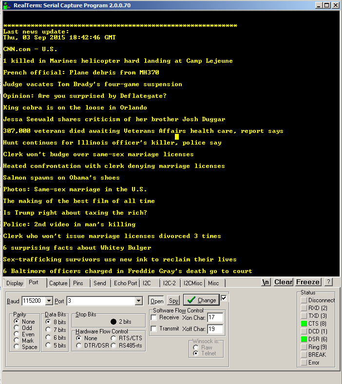

The Freedom Board will be connected to the internet. As an example, this demo connects to an HTTP server in the internet, download to MCU some data (Lastest news from an newspaper website) and displays it through the Serial connection.
You can modify this demo for your own application, using the TCP/IP and UDP/IP provided by the LwIP.

- Some cellphones need additional current to detect that is attached to a host.A external power is needed in this situation.For FRDM-K64F I suggest to use the J27 footprint to provide 5V and short the diode D13.
