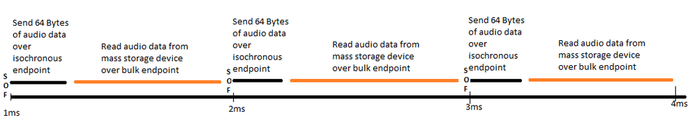

I am working on a K22 series controller and using latest USB stack. I have connected 2 MSD & 1 speaker on USB and trying to read the .wav file from MSD and playing it on speaker.
For playing sound, reading data in buffer1(1152bytes) &sending 64 bytes every 1ms and while sending audio data trying to read in buffer2(1152bytes).
I observed on analyzer that traffic on USB bus which is coming as follows,
https___community.nxp.com_servlet_JiveServlet_showImage_2-983111-210812_pastedImage_2.png
since data is not getting sent every 1ms, sound played is distorted. (Why data is not being read from MSD after sending audio data in 1ms time frame?)
and i want to achieve something like as follows
https___community.nxp.com_servlet_JiveServlet_showImage_2-983111-210805_pastedImage_1.png
i was not able to do this although i am using the usb stack APIs.
Please let me know how i can implement this.
