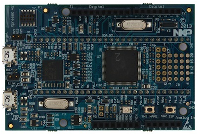

     The purpose of this document is to use USB as an example for developing the secondary bootloader and the code was tested using the LPCXpresso 11U68 evaluation board.
      The MSCD presents easy integration with a PC‘s operating systems. This class allows the embedded system’s flash memory space be represented as a folder in Windows/Linux. The user can update the flash with the binary image using drag and drop, so the following sections will present a guideline for development and implementation of the USB secondary bootloader design, configuration, and test.
     USB secondary bootloader code is base on the USB Mass Storage Class demo. However in this application note, we do not attempt to explain how the Mass Storage Class is implemented.
Fig 1 LPCXpresso Board for LPC11U68

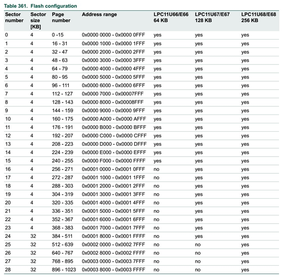

MAX_USER_SECTOR – This parameter is device dependent. In a 256 KB device, it will be 29 sectors, however the size of the last 5 sectors become the 32 KB instead of the 4 KB, so in the application, MAX_USER_SECTOR chooses 23 (Fig 2).

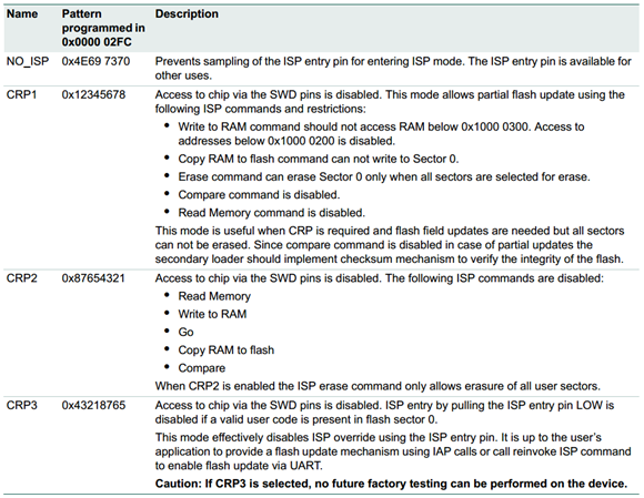

CRP – Code Read Protection. This parameter allows select the desired CRP level. Choosing CRP3, the primary bootloader’s entry mechanism check will be bypassed. Fig 3 for CRP details.
Fig 2 Flash sectors in LPC11U68
Fig 3 Code Read Protection (CRP)

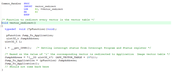

Handing interrupts
     The LPC11U68 contains a NVIC (Nested Vectored Interrupt Controller) that handles all interrupts. When an interrupt occurs the processor uses the vector table to locate the address of the handler.
     On the LPC11U68 the vector table is located in the same area of flash memory as the secondary bootloader. The secondary bootloader is designed to be permanently resident in flash memory and therefore it is not possible to update the contents of the vector table every time a new application is downloaded.
      The Cortex-M3 core allows the vector table to be remapped; however this is not the case with the Cortex-M0. Because of this, the secondary bootloader has been designed to redirect the processor to the handler listed in a vector table located in the application area of flash memory, see Fig 5.
Fig 5
User application
      To execute the user application the secondary USB bootloader will load the new SP and PC values into their respective registers, allowing the CPU to execute the new code correctly. Therefore, the user application must be built so that it can run from that starting address. In the application, this address is 0x00003E00. So relocate the user application storage area by following corresponding IDE’s User Guide.

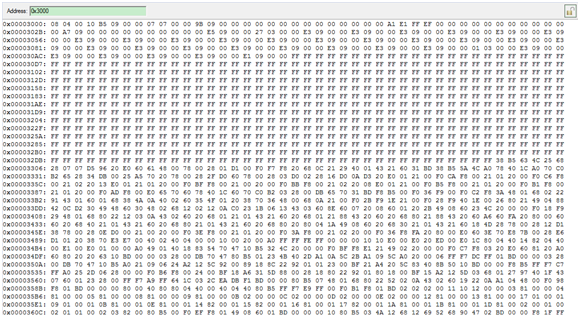

  • Review the values of the user application in the relative area , see Fig 8;
Fig 8
