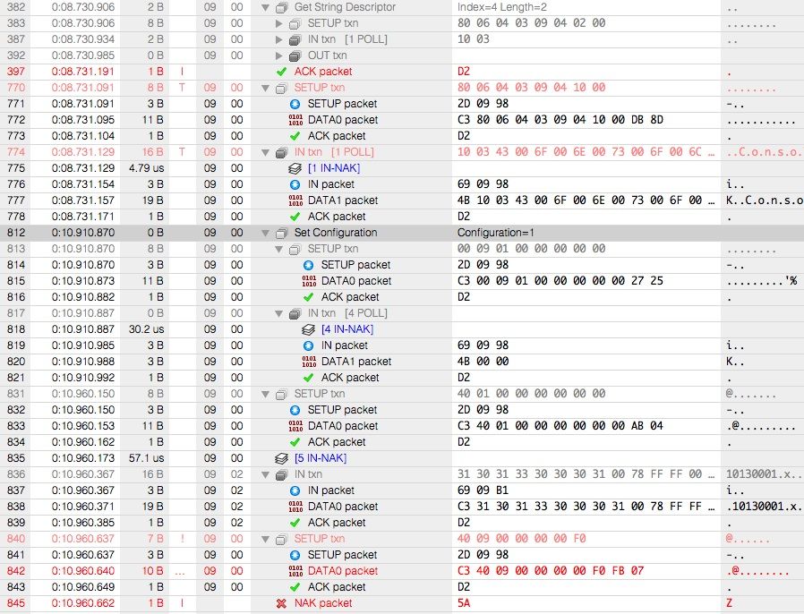

Below are two images from a usb analyzer that can hopefully help illustrate the issue. Any help would be greatly appreciated!
Elizabeth
The first image shows the usb communication when there is success. The desktop software begins with the "Set Configuration" command (line 812). The first request for data from the device occurs at line 831 which is a vendor request. The device responds over a bulk endpoint. This is followed by another vendor request for the next set of data. The device responds again and this sequence continues until all requested data has been received.
     SUCCESSFUL RUN - Running from JTAG

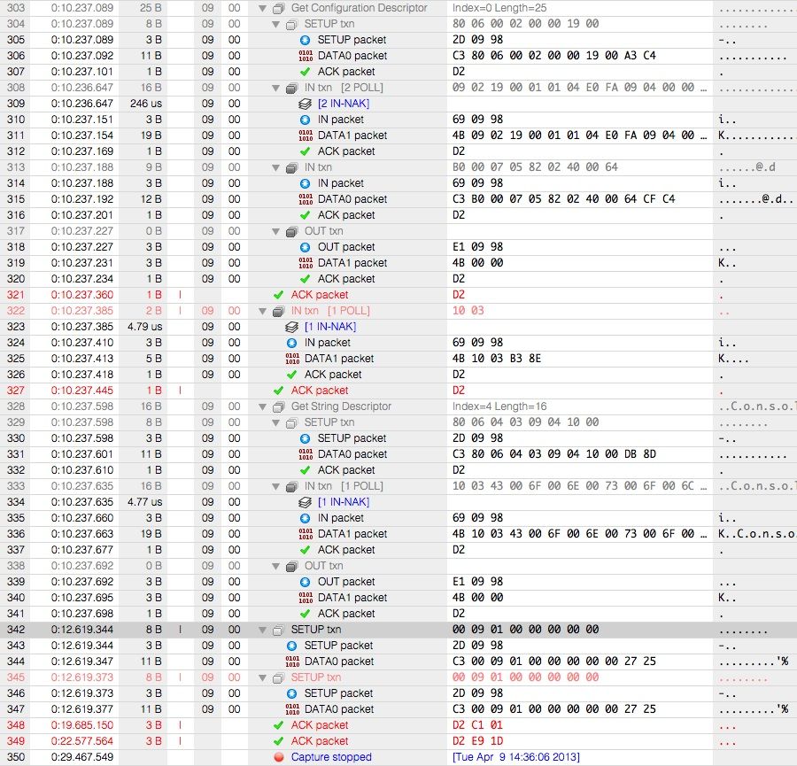

The image below shows an unsuccessful run. Enumeration proceeds normally and the desktop software issues the "Set Configuration" command at line 342. At this point the setup packet doesn't complete because the device does not ACK after the data stage. The host retries the command but again no response from the device.  I think the device then sends the ACKs but since they are 3 bytes instead of 1 they don't serve to re-synch the communication. The device doesn't generate any other token done interrupts but does respond to the the SOF interrupts.
FAILED RUN - Running from a POR
