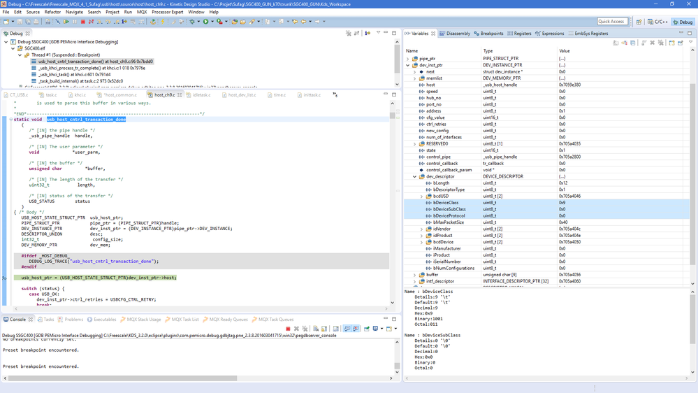

I tried to go up the code and compare between the good and bad key.
When the function usb_host_cntrl_transaction_done is called, the pointer dev_inst_ptr, which is assigned to handle->pipe_ptr->DEV_INSTANCE have the following value:
With the good key: dev_inst_ptr.dev_descriptor.bDeviceClass / SubClass / Protocol = 0x00, 0x00, 0x00 (Like in the LOG file obtained with the USB tool):

With the bad key, these values are 0x09, 0x00, 0x00 but the Log file is Ok (like the good key):
Then due to these values, later in function usb_host_driver_info_match, the following test is TRUE:

Now, it difficult for me to know why the Class value is 09 instead of 00. It is difficult to me to understand the code executed before with the "PIPE"
