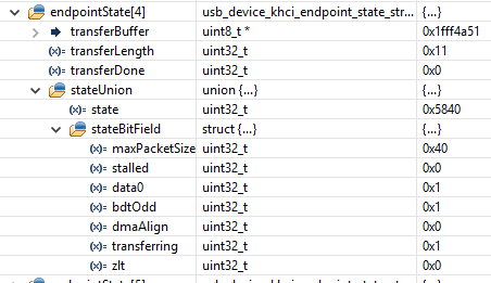

dusek_martin
This is my usb communication when the communication freezes. Host wants to read data from endpoint 4 (that is interrupt in endpoint) but the transaction ends with NAK.
At the same time, this is the state of endpoint 4:
(endpointState[0] has also always tranferring = 1, all other endpoints has transferring = 0)
Also, no there are no USB interrupts at that time.
