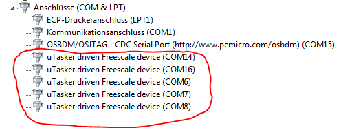

I have configured USB-CDC as composite device to 5 connections. That is, the device appears as 5 virtual COM ports, each connected to a different UART (single USB to 5 serial interfaces).
This allows me to communicate via 5 UARTs of a Kinetis (such as the K60) via the single USB device cable - it looks like this:
