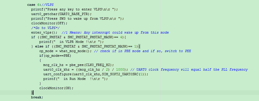

Hui_Ma
Hi, Chuck,
KL25 example code provides [low_power_mode] mode about low power mode transfer and wake up , there also include VLPS mode.
I abstract VLPS mode related code for your reference:
When wake up from VLPS mode, it need to check core works in VLPR mode or RUN mode and MCG module status.
More detailed info, please download and check from below link:
http://cache.freescale.com/files/32bit/software/KL25_SC.exe
Wish it helps.
best regards
