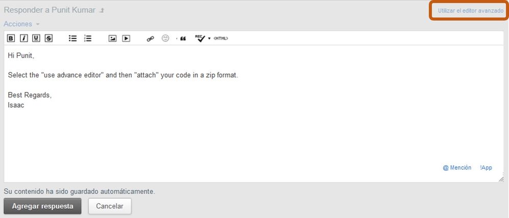

isaacavila
Hi Punit,
Select the "use advanced editor" and then "attach" your project in a zip format.
Isaac
