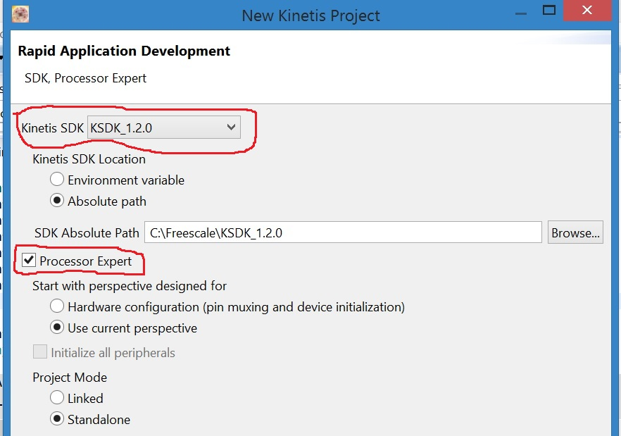

File→New→Kinetis Project…. Name… boards FRDM-K64
Select KSDK 1.2.0 or KSDK 1.3.0
Select Processor Expert
Set Build Options

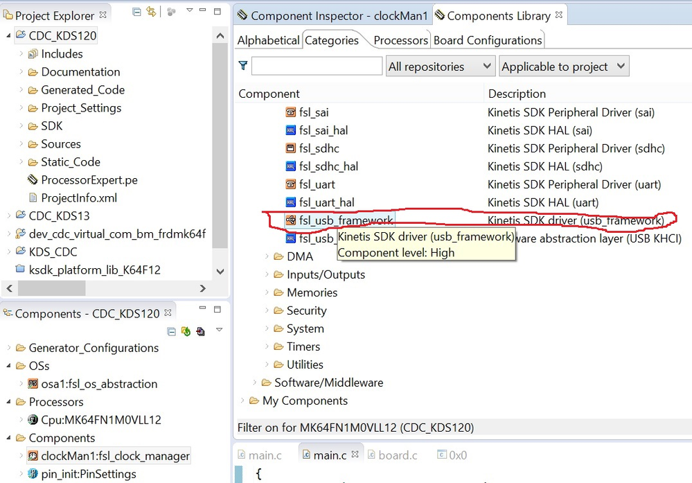

Now I find the fsl_usb_framework component from KSDK 1.2.0 or KSDK 1.3.0
and add it to project and inherited components :

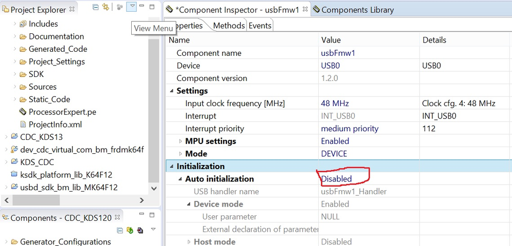

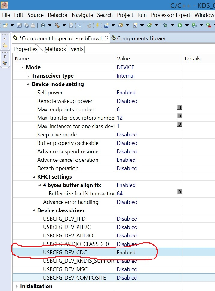

Select usbFmw:fsl_usb_framework Properties Mode and Select Device class driver USBCFG_DEV_CDC Enabled
Select usbFmw:fsl_usb_framework Properties Initialization
and Select Auto Initialization Disabled
Click Generate Prosessor Expert Code

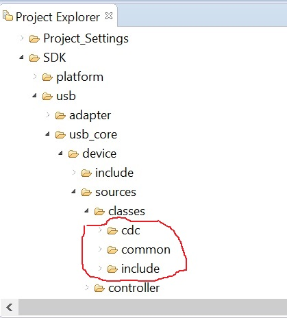

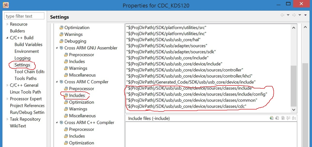

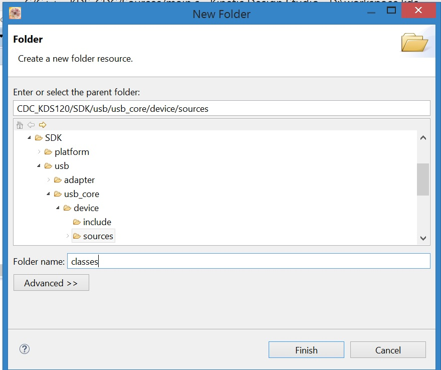

Create New Folger classes
Add
Includes Path
"${ProjDirPath}/SDK/usb/usb_core/device/sources/classes/include"
"${ProjDirPath}/SDK/usb/usb_core/device/sources/classes/include/config"
"${ProjDirPath}/SDK/usb/usb_core/device/sources/classes/common"
"${ProjDirPath}/SDK/usb/usb_core/device/sources/classes/cdc"
and Apply.

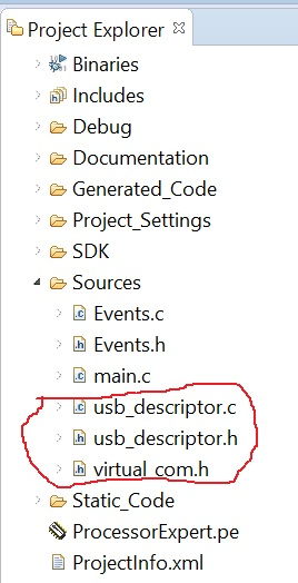

Copy C:\Freescale\KSDK_1.X.0\usb\usb_core\device\sources\classes\
to {ProjDirPath}/SDK/usb/usb_core/device/sources/classes/
folgers:
/cdc
/common
/include
Copy c:\Freescale\KSDK_1.X.0\examples\frdmk64f\demo_apps\usb\device\cdc\virtual_com\
to {ProjDirPath}/Sources/
files
virtual_com.h
usb_descriptor.h
usb_descriptor.c
Note: Not copy virtual_com.c
Next step change main.c based virtual_com.c.

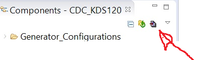

  View attachment projects.
  Click Generate Prosessor Expert Code.

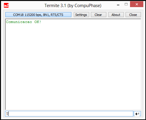

I tried to change some configurations on USB libraries of the main project code, and I didn't have sucess.
The solution was very, but very simple. If somebody have the same problem, here is the solution...

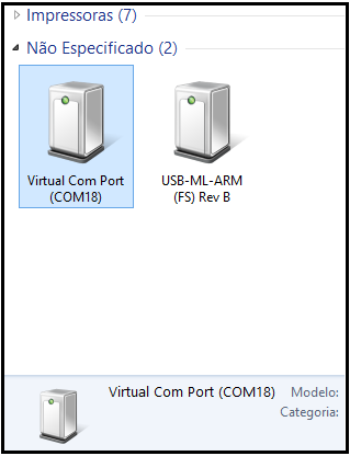

The device was detected and the driver update was done too, like in the image below:

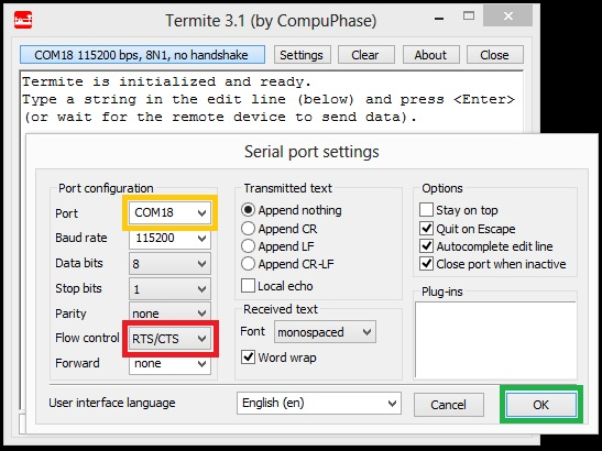

The configuration for the device works on "Termite", is shown below.
We need to set the configurations of the "Flow Control" to RST/CTS.
Like in these steps:
Yellow: Set the serial COM port referenced by the Virtual Com Port driver (.inf).
Red: Set the Flow Control from "none" to "RTS/CTS".
Green: Press the ok button.
A test  is shown below:
Comunicacao OK! (Communication OK!)
If ou have your own application software, you need to verify the Flow Control configurations for this applications with the KL27Z series, and it works nice!
Thank you to everyone!
